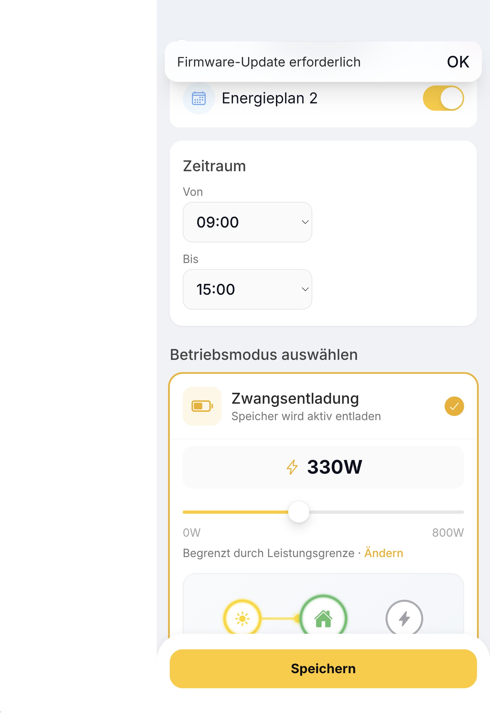

Since yesterday i cant change energyplans in the app. Says “firmware update needed”…

I cant change anything in the energy plans. It says “firmware update needed” and sets all back to the status before.

thanks. I have only one energy plan → Smart Meter Modus 00:00 - 23:59 Uhr. The hint “firmware update needed” will be not shown in my app. :wink:
