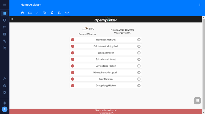

Without seeing this I have done the same, it looks nice, but I have a problem, Opensprinkler don’t have SSL, to get this working I have to turn off SSL in HA. I’m not that technical and haven’t found a way around it. Either no SSL in HA or no Iframe for opensprinkler.
Any tips or hint would be helpful here.
The thing I’m disatisfied with in opensprinkler is the weather report, not that accurate for Sweden, this I will solve in an ugly way, I bought a Sonoff 5V that I will stop the opensprinkler via the rainsensor with if it rains according to the Swedish forecast from HA.
I use reverse proxy in synology to give ssl to opensprinkler… it would however be best if the opensprinkler plugin was part of HACS or official hassio plugin with ingress…
