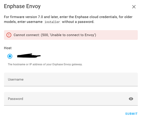

Our system is newer so I’m using the IP from the Envoy Gateway as the “Host” input. And then my Enlighten cloud log in credentials.
My firmware is D8.
I’ve reached out to Enphase and have varied answers from we don’t support BAS integration in the United States to “you will have to create a static IP”.
I’m not great with networking so if it’s an IP specific thing, I haven’t been able to solve it yet.

My firmware is 8.2.4345, so I would expect the core/stock integration to work.
I had my Envoy Gateway connected to a guest wifi, so HA never found it automatically. I just switched it over to my primary wifi network, which HA is on, and it did now discover it.
I’m using the IP address for the Envoy Gateway that comes up on my router, along with my Enlighten log in credentials at this window, but getting the ‘cannot connect’ error.
In speaking with Enphase, they suggested trying to set the enphase gate to a static IP. I’m not network savvy, so I wasn’t sure how to execute this.
I just sat on the phone with both Envoy and Eero (my router manufacturer) and was eventually able to set the static IP on the Envoy and then reserve that IP on the Eero and now everything is integrated!

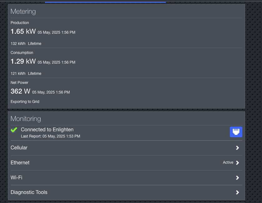

For anyone wondering where to set the static IP in your Enphase Envoy controller,
  • Open the current IP address or http://envoy.local
  • Login using your Enphase Enlighten credentials
  • Under “Monitoring”, select your active connection. (Use Ethernet. No excuses. You should’ve had the installer run a cable!) :slight_smile:
  • Under Ethernet Configuration, click “Use Static IP”
  • Enter the IP Address, Netmask, Gateway IP, Primary DNS Server (your gateway, most likely unless you already know why it shouldn’t be, and an optional Secondary DNS Server
  • Click Update
(If you’re wondering “Why aren’t you producing more power?”, it’s been several of the few overcast days we get 'round these parts since PTO three days ago!)
