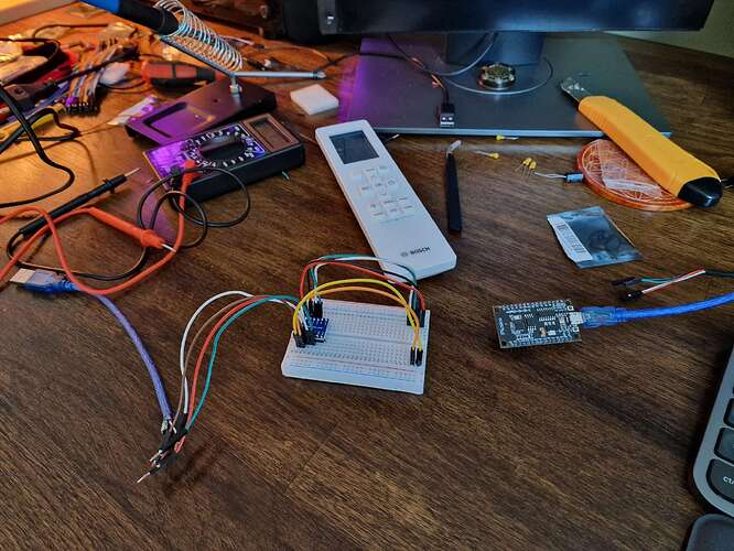

I’m trying to get my Bosch Climate 5000i AC to work with an ESP8266 using ESPHome, but I’m facing some issues with the UART communication. Here’s what I have:
  • ESP8266 with CH340G
  • AC’s UART sends 5V signals; ESP8266 works with 3.3V
Can somebody help me, please? I have tried with both ESP32 and ESP8266 boards and i get the same TX error.
I’ve connected TX/RX directly, but I think I need a level shifter. Can someone guide me on how to properly connect a 2-channel bidirectional level shifter in this setup? Any wiring diagrams or detailed instructions would be greatly appreciated.

I added a level shifter, since the AC use 4V+ and the ESP8266 3.3V. The AC still not recognize the ESP. Can somebody help me, please?
I have a Bosch Climate 2000, which looks very similar to your unit, and I’m also unable to configure it. I added a level shifter as well, but got the same result as shown in your logs.
Did you happen to fix it? Thanks!
