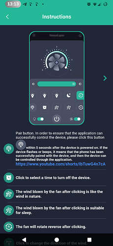

The setup process consists of turning on the wall switch and then, from the app, tapping the button to search for devices. If you do it within the first 3 seconds after powering on, the fan enters Bluetooth pairing mode and can be added successfully.

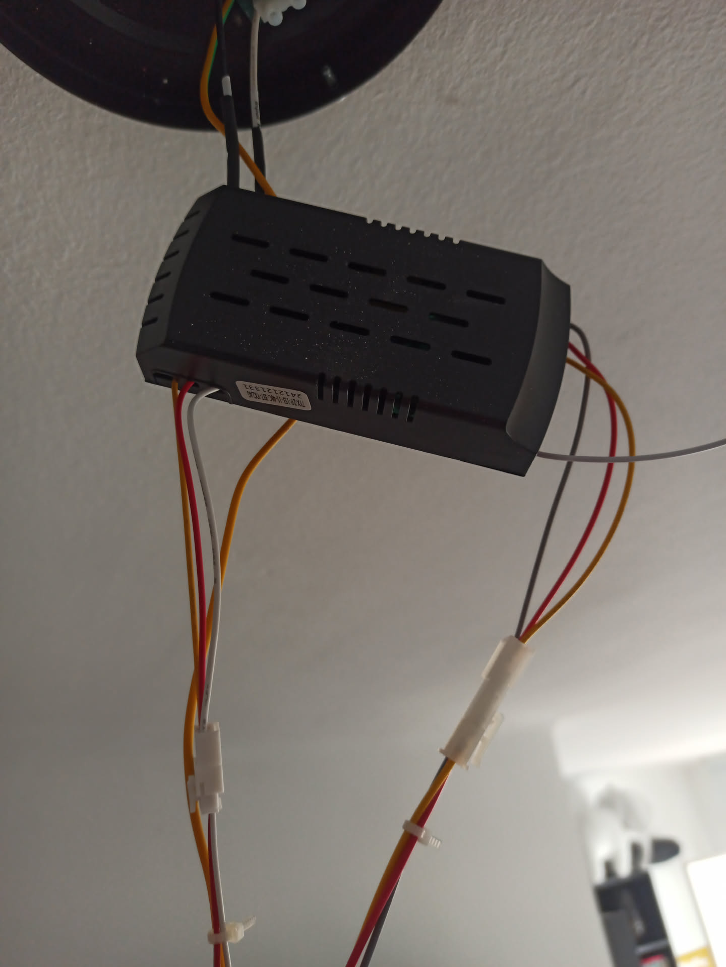

I actually disassembled the fan to take some pictures of the light controller, but there isn’t much information printed on it. There’s a wire that looks like an antenna, so as you said, it seems to use 2.4GHz RF.

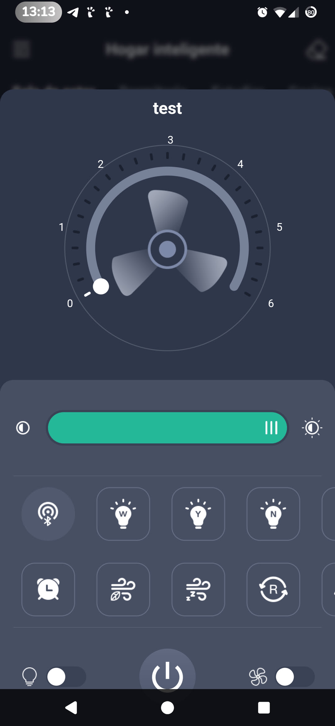

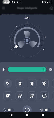

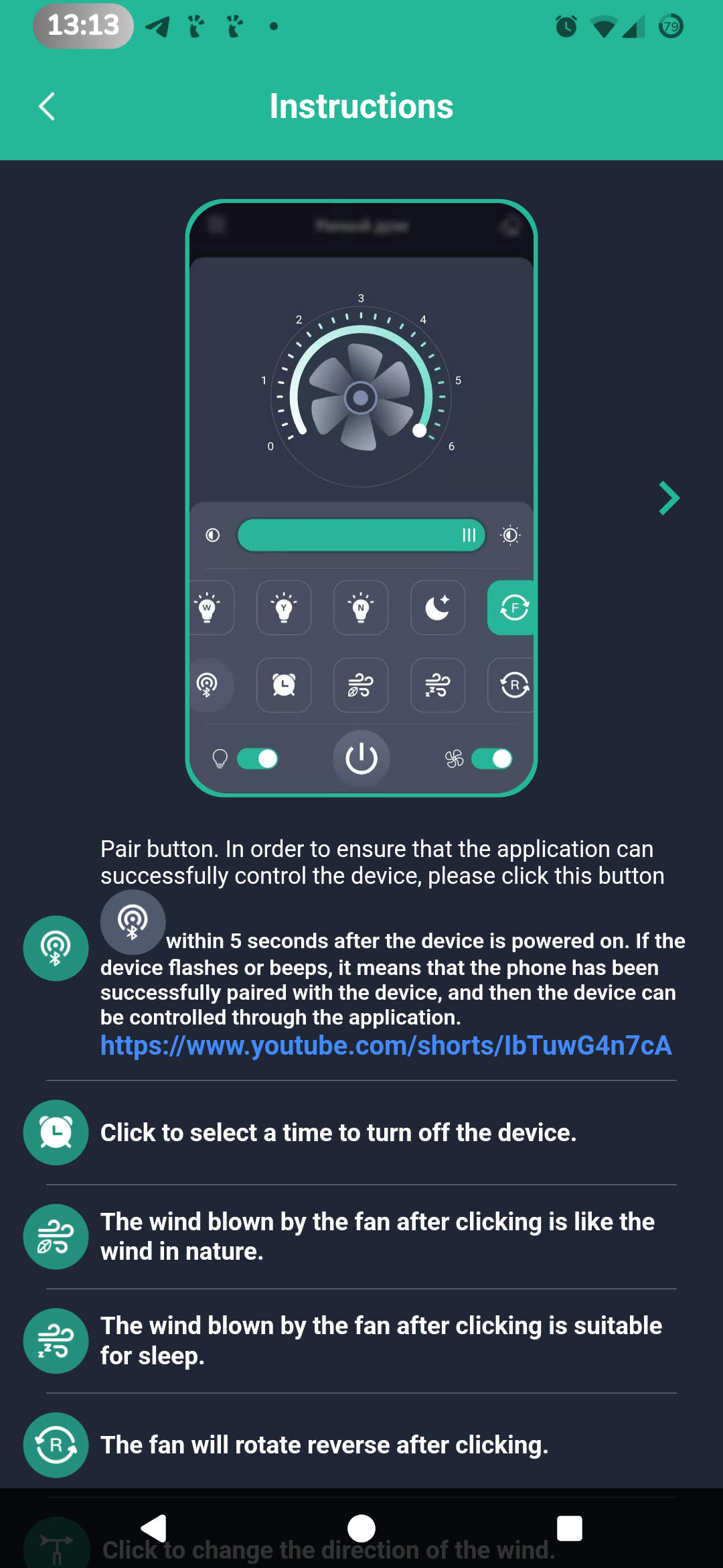

Three of the wires go to the LED light, and the other three are connected to the fan motor. I’m also attaching a screenshot from the app.
I understand that since the app connects via Bluetooth, there should be some way to capture or interact with the communication — maybe by sniffing the Bluetooth data or something similar.

Foto of a black box really doesn’t help, good closeup image of the circuit board would be minimum…
Anyway, simple wire is rarely used as 2.4G antenna, so that hints back to 433 /315MHz remote.
The same lamp is also sold as wifi and no-wifi version, so maybe they just kept the same remote.
To sniff and reverse engineer the BLE protocol you need plenty of time… And to swap the controller is likely going to cost you more than the lamp, you need cww led driver and bldc motor driver.
So only viable option to my opinion is to replicate the remote signal or to attach to the remote receiver module inside. Or the remote control itself…

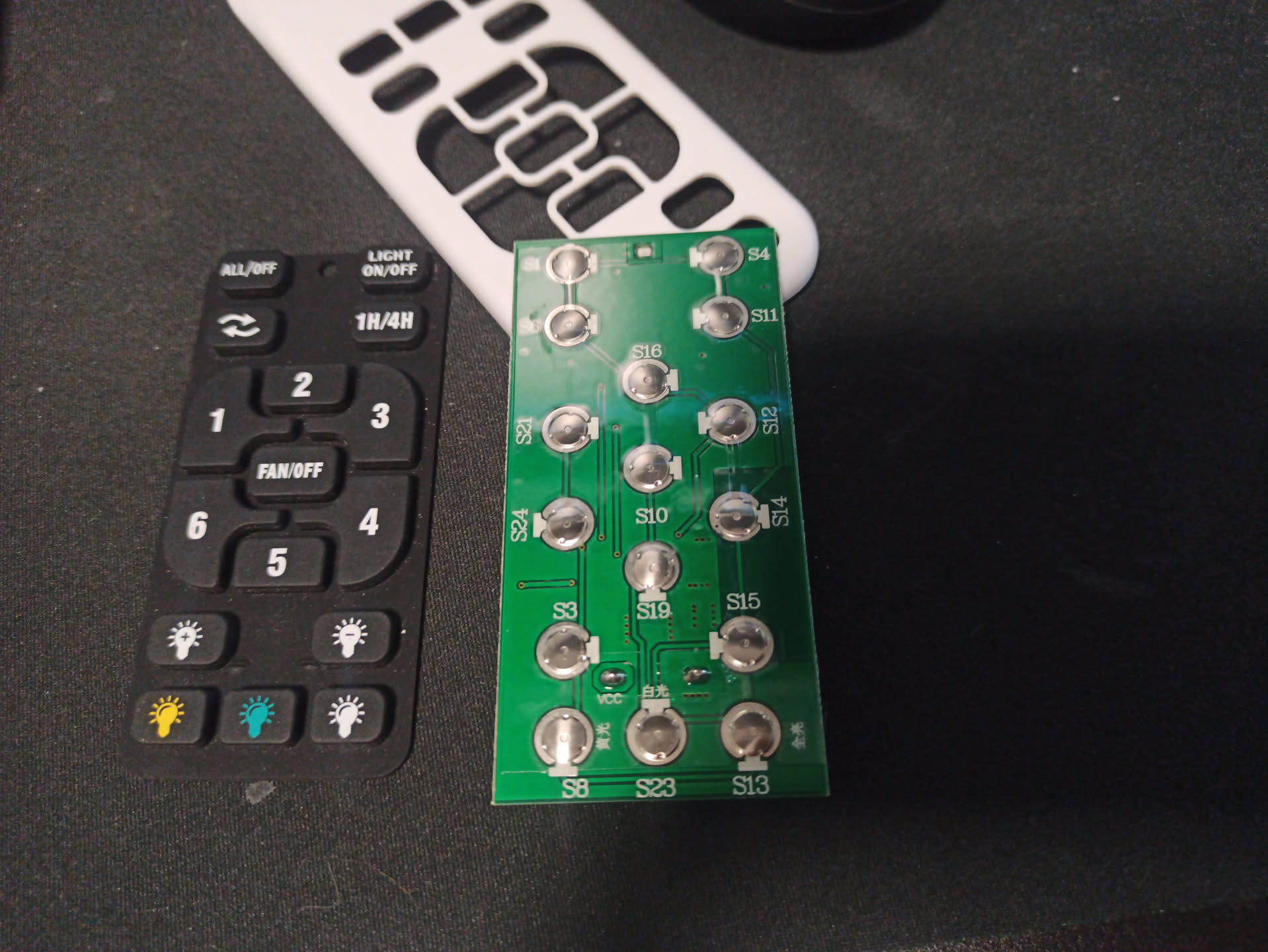

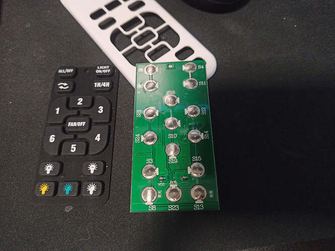

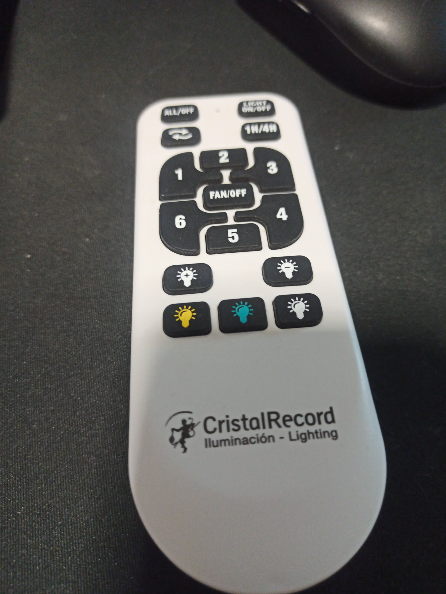

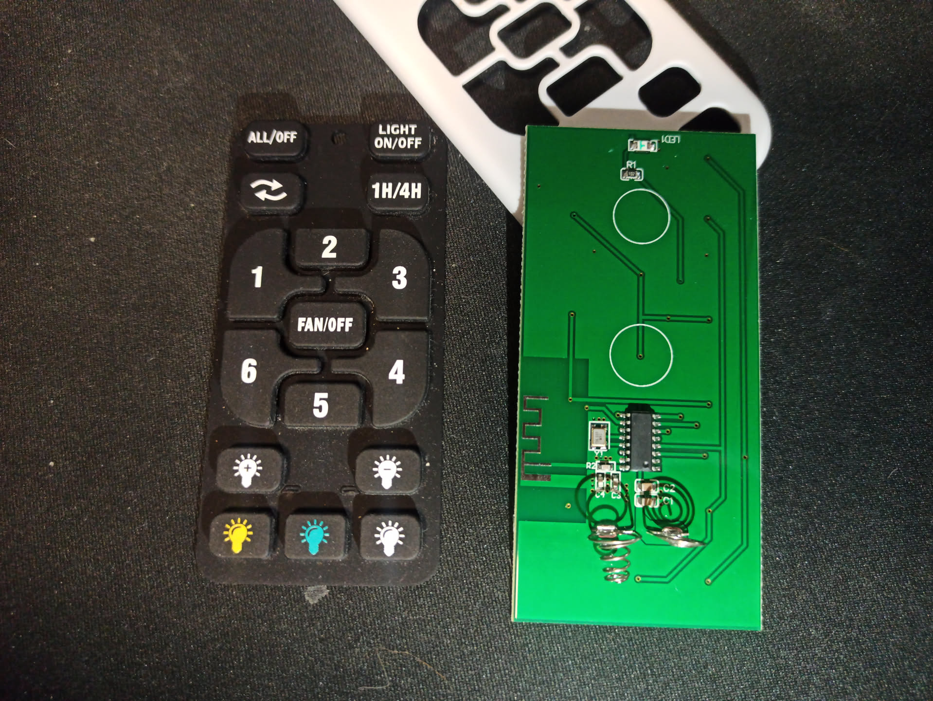

Hi — sorry about the poor photo of the box, T_T; I didn’t think the interior would be the interesting part. Instead, I’ll send photos of the remote in case they’re useful.
Anyway, I already tried a device meant to replicate IR and RF signals and it didn’t seem to detect anything, so I’m not sure about 433/315 MHz.
Specifically: I have an IR Controller Pro (Tuya) and a generic “replicator.” I also tried a Flipper Zero to see if it would pick up any signal, and none of them register anything when I press the remote.
Which RF device would you recommend to try to replicate/sniff the signal? Is it worth trying to capture BLE (if it actually uses BLE) or would it be more practical to open the lamp and identify the receiver/module/IC to tap into?
Maybe, as @ShadowFist suggests, would it be better to put an ESP32 in the remote?
Interestingly, I have another identical fan in a different room, and each remote only works with its own fan — they can’t be used interchangeably.
Ohh… That button circuit is not hack friendly at all…
And the antenna design is again pointing back to 2.4GHz.

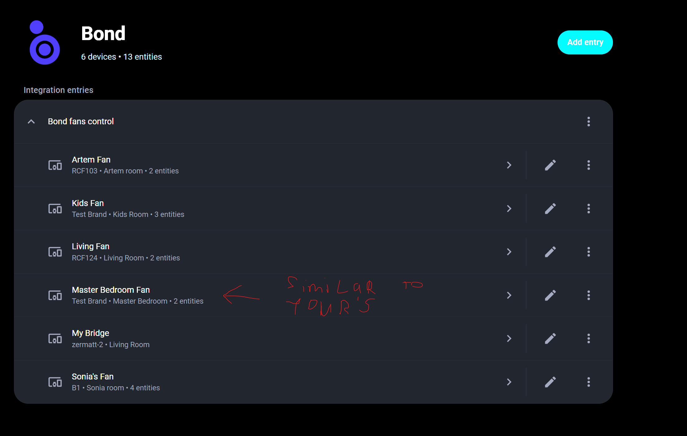

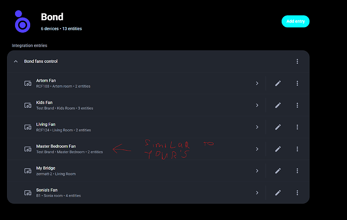

My other recommendation, without intervention will be BOND ( link above)
Here is my Bond app fans ( all of them except Master Bedroom ( Tuya) is not smart, but with remote
