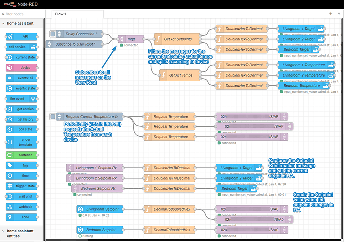

I used a bit of a different strategy to get this working:
Most guides / info I could find involves redirecting the communication between the Thermostats and the Eurotronic MQTT Broker to a local MQTT Broker, I wanted to avoid that and basically wanted Home Assistant to act like the iOS App that came with the devices so that no rerouting is required, this obviously means that I am now dependent on the Eurotronic MQTT Server staying alive, this is how I did it:
  1. Setup a functioning system (Devices registered and configured using the iOS app).
  2. Get the login credentials from the iOS app: (Capture the communication between iOS and the Eurotronic Broker using Wireshark)

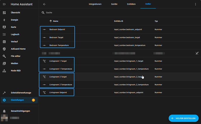

  3. Create Helper devices in Home Assistant to store the values we will be communicating for each
    Thermostat:
    a. Setpoint.
    b. Actual Setpoint.
    c. Current Temperature.
  4. Create a Flow in Node Red to interact with the Eurotronic MQTT Broker:

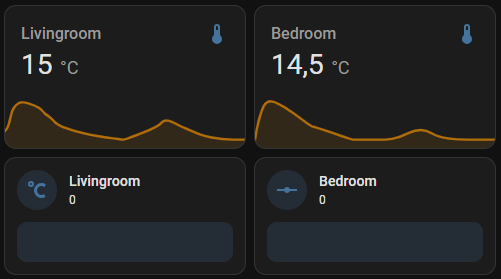

  5. Add the Interface components on the Dashboard:

Here an export of the flow in which I replaced sensitive info with the following tags:
{{USER_ID}} → 0000XXXX
{{THERMOSTAT1_MACADDRESS}} → Mac Address of Thermostat 1
{{THERMOSTAT2_MACADDRESS}} → Mac Address of Thermostat 2
{{BEDROOM_MACADDRESS}} → Mac Address of Thermostat 3
https://pastebin.com/raw/DZHdVqFb

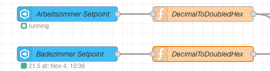

Thanks for your information. I was able to implement it as my first HA and NodeRED experience.
2 Additions:
The setpoint rounding for the 0,5°C steps wasn’t working correctly. Here is the code that I replaced in the "DecimalToDoubledHex
if (typeof msg.payload === "string" || typeof msg.payload === "number")
    let number = parseFloat(msg.payload);
    let doubledNumber = number * 2;
    if (doubledNumber < 16) {
        return {payload: "#0F"};
    let hexValue = Math.round(doubledNumber);
    let hexString = hexValue.toString(16).toUpperCase();
    // Stelle sicher, dass der Hex-Wert 2 Zeichen hat
    if (hexString.length === 1) {
        hexString = "0" + hexString;
    return {payload: "#" + hexString};
return {payload: "#00"};
At first I was struggling to connect to the MQTT Server because I forgot to replace the IP with my wireshark sniffed IP.
EDIT:
What I can’t figure out is how to implement these Dashboard displays above.
