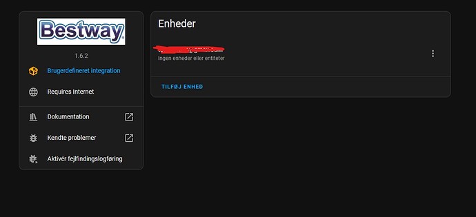

When i try to use haccs integration ha-bestway, it prompts for a username(mail) and password. Tried to use the login fra earlier spa (bestway account) - but no luck, because no spa is connected to this account.

This is the image from the integration (used login to old bestway app), see no entities.

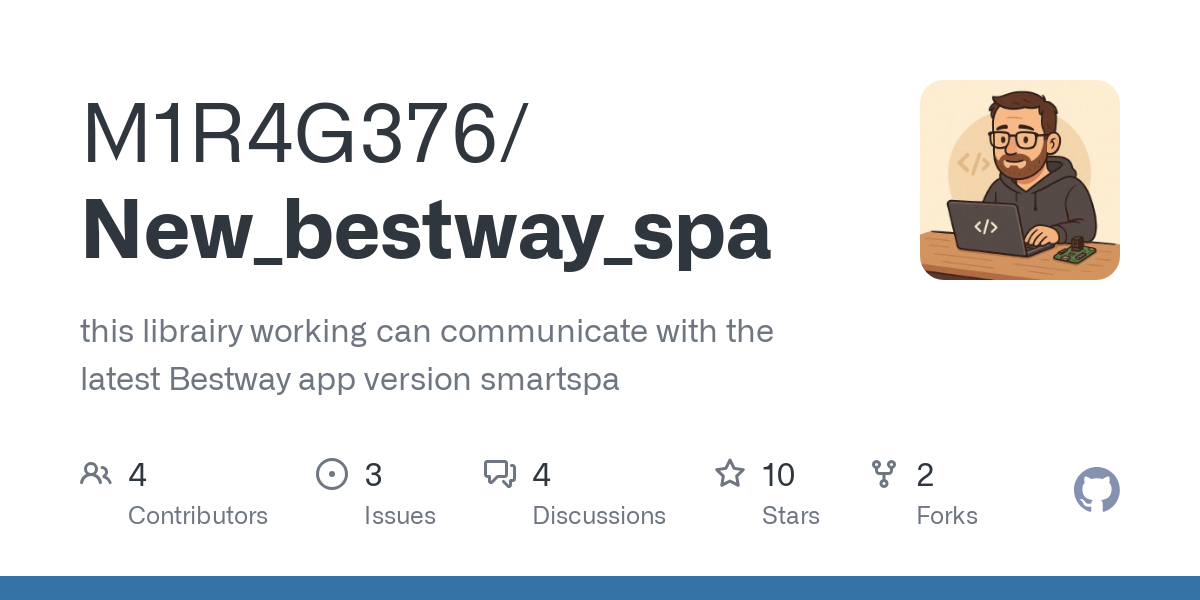

There’s already a GitHub development issue open. You can follow the progress here:
Just an update to here as well, there is progress and i can currently control the spa from HA. Not a ready-made HACS add-on yet, but great work from the people who have been working on this.
I tried to get the most out of this thread, but I am not able to figure out how to connect my new Lay-Z to HA. I´m using the SmartSpa and it doesnt require a log in. Is there no other way? Thx in advance

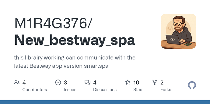

Please look at the repository with updated documentation here:
You need two mobile devices - one to share the QR code and the other one to read the qr-code and utilize proxy to capture the required information in order to the the integration working.
Just got a Lay Z Spa Carrara and found this thread. I followed the Github instructions (using an Android Phone B) and everything worked like a charm. Great work and good explanation! Really happy I can control this spa via Ha now.
