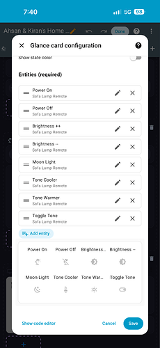

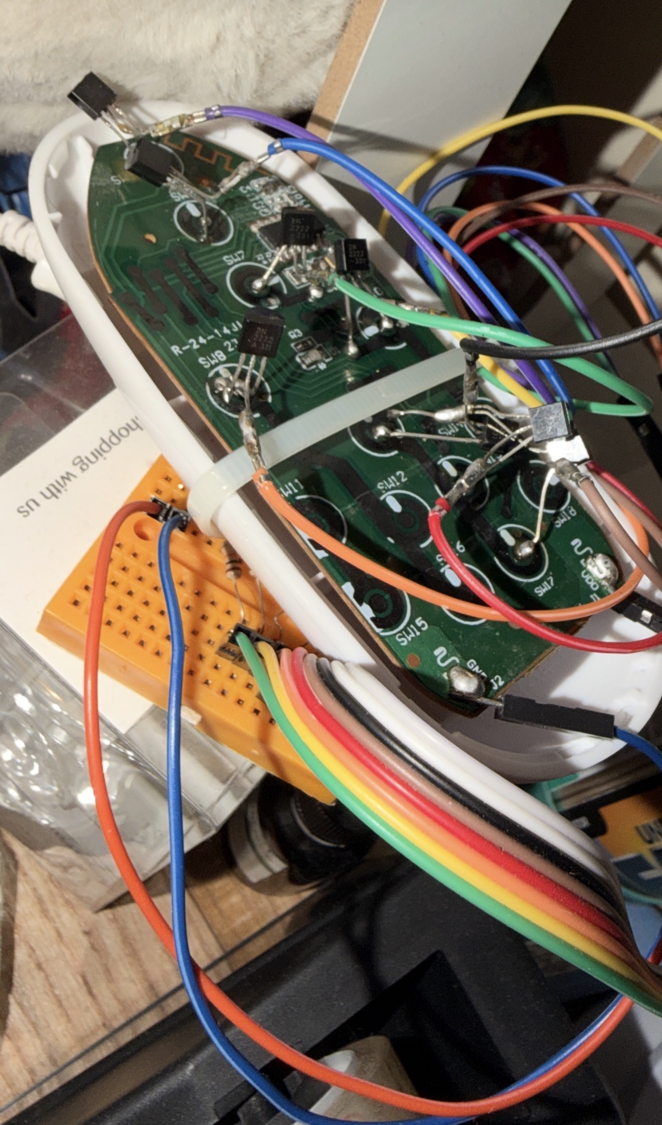

Well thats one way to do it :
If you don’t want to use the physical remote anymore, this is what can be done to safely integrate it to the HA, just a couple of NPN transistors, some 10k resistors and an ESP8266 and voila!
“Please keep in mind that at this point if time it is in a prototype stage, will be making a 3d printed case for this gimmick”
