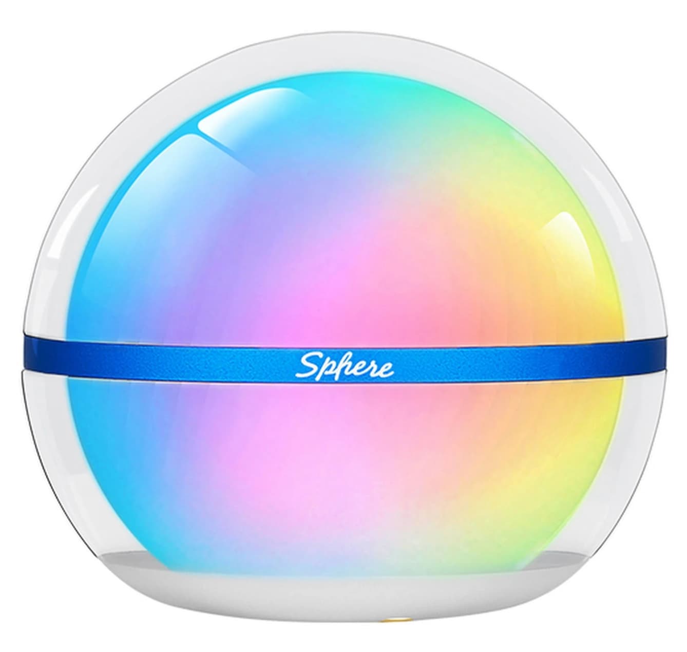

and was looking for a way to integrate it in HA. It should use a BLE Sig Mesh standard and I was able to add one to a Moes Tuya Bluetooth Gateway (https://www.aliexpress.com/item/1005005637088709.html) but only via Olight proprietary app and not with SmartLife/Tuya app.
I had to put the gateway in pairing mode, then add it to Olight app (same procedure as adding a Sphere…). After this you can control the light (with the app) via the gateway through WiFi.
Now if I could extract the local keys it should be possible to control the Spheres in HA with LocalTuya/TuyaLocal etc…
To answer my own question, this is how I managed to integrate it in HA. Step 1 - Add Sphere to Bluetooth Gateway

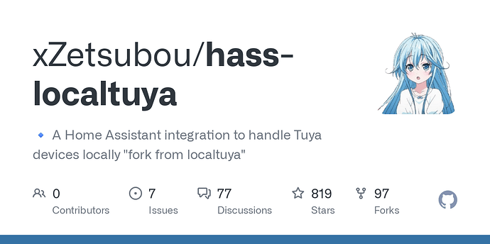

I had to use a modified version of Localtya, the standard one from rospogrigio don’t support devices connected though hubs/gateways and Tuya Local from make-all didn’t worked.
This is the version that I used (note that this will overwrite rospogrigio’s localtuya):
Add the integration, then Add a new device: you will need to use devId, localKey and IP (the private one, you may need to recover this from your router…) from the Bluetooth Gateway and nodeId from the Sphere…
