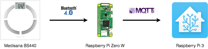

recently I’ve added my BS440 body analysis scale to my home automation system.
In order to achieve a fault tolerant system a Raspberry Pi Zero W was used in the close surrounding of the scale. It served as Bluetooth enabled gateway, which forwards measurements to Home Assistant using MQTT messages.
Bluetooth Gateway (Raspberry Pi Zero W)
The Bluetooth communication was done using the project of keptenkurk, which is available on GitHub. In order to install the Bluetooth stack on the Raspberry Pi, the following step by step instructions were used: https://keptenkurk.wordpress.com/2017/03/05/connecting-the-medisana-bs440-bluetooth-scale-epilogue/. I’ve implemented a generic MQTT plugin for the project. It’s currently available on https://github.com/jinnerbichler/BS440 until the pull request was accepted. The plugin is configured by renaming BS440mqtt.example.ini to BS440mqtt.ini and replacing the proper parameters of the MQTT client. Delete username and password if no credentials are necessary. Don’t forget to install the MQTT client by executing pip install paho-mqtt.
The MQTT client sends the measured data using the topics bs440/person1/ to bs440/person8/ and the following JSON encoding:
{"weight": 63.0, "timestamp": 1502822395, "age": 26, "activity": "normal", "tbw": 51.5, "person": 1, "valid": true, "fat": 26.6, "gender": "female", "model": "BS444", "muscle": 33.5, "kcal": 2217, "bone": 3.0, "size": 163}
Home Assistant (Raspberry Pi 3)
Home Assistant and the MQTT broker are running on a Raspberry 3, which is placed further away from the scale.

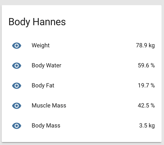

The following MQTT sensor was added to the configuration file:
- platform: mqtt
  state_topic: "bs440/person1/"
  unit_of_measurement: "kg"
  value_template: '{{ value_json.weight }}'
- platform: mqtt
  unit_of_measurement: "%"
  value_template: '{{ value_json.tbw }}'
- platform: mqtt
  value_template: '{{ value_json.fat }}'
- platform: mqtt
  value_template: '{{ value_json.muscle }}'
- platform: mqtt
  value_template: '{{ value_json.bone }}'
In the end the following data is available on Home Assistant.
