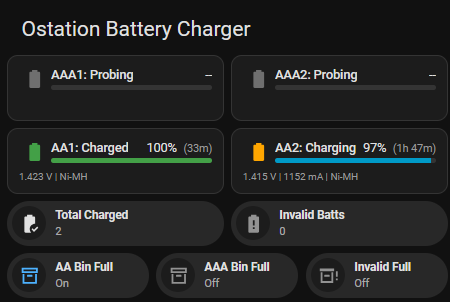

  • The Advanced Method: If you want voltage, current, and status, you need template sensors to decode the hex-encoded packets, and the UI below makes that look pretty.
Uploading: image.png…
  • The Super Quick Method: If you want a super quick implementation, just drop the device YAML into your tuya_local device folder. You don't need the UI and template sensors below if you don't care about more than on/off and basic stuff.

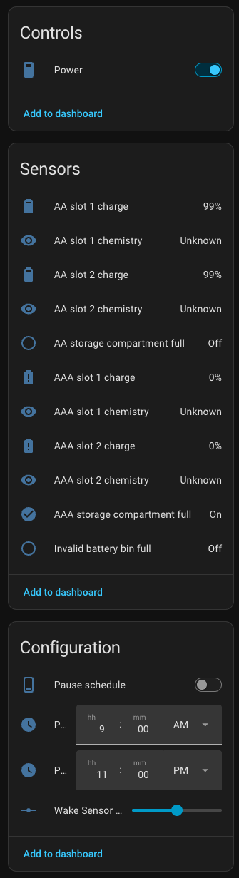

  1. Configure the Integration: Go into Devices & Services on HA and MANUALLY add a new Tuya Local device.
    CRITICAL: Be absolutely sure to pick 3.5 interface for Tuya. Put in your local key that you got via ADB, your device ID, and IP. THEN you will be asked which device interface, and Charger (Ostation) will show up. Now you can simply add the result to your UI.

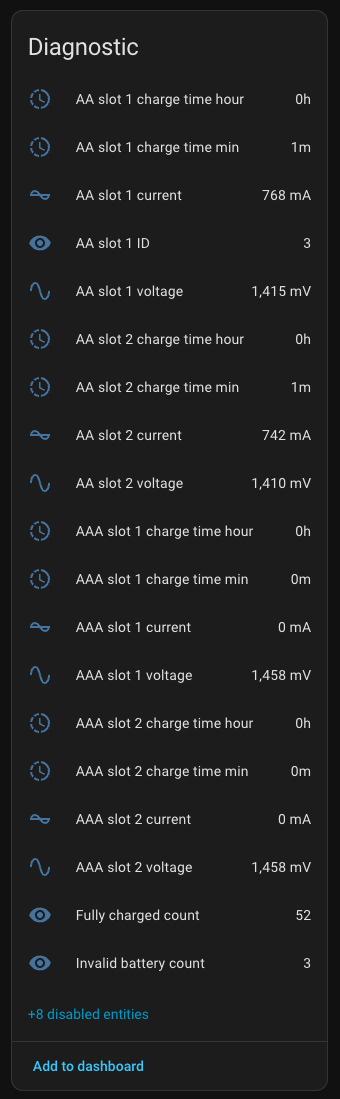

The DP Slot Keys
For reference, here are the core DP (Data Point) keys the charger uses:
  • 101: Global Power State (Boolean)
  • 102: "Fully Charged" Counter (Matches the app GUI)
  • 108: "Invalid Batteries" Counter
  • 110: Live Multi-Bay Telemetry (The Hex Payload)
  • 111 / 112: Paused Charging Schedule Controls

Step 3: The Lovelace UI
I never did find HA support for vertical progress bars like in the original olight olstation app. For progress bars I am using the Entity Progress Card (via HACS by KO4LA).
Note that when it says probing, it will show current/last voltage values, etc. So only when charging will it turn green.
type: vertical-stack
cards:
  - square: false

      - type: vertical-stack
        cards:
          - type: custom:entity-progress-card-template
            entity: sensor.ostation_slot_4_percent
            icon: mdi:battery
            color: >-
              {% set pwr = is_state('switch.ostation_charger_power', 'on') %} {%
              set ch = states('sensor.ostation_slot_4_chemistry') | int(0) %} {%
              if pwr and ch > 0 %} green {% else %} grey {% endif %}
            bar_color: >-
              if not pwr %} AA2: Off {% elif ch > 0 %} AA2: Charging {% else %}
              AA2: Probing {% endif %}
            secondary: >-
              {% set ch = states('sensor.ostation_slot_4_chemistry') | int(0) %}
              {% set p = states('sensor.ostation_slot_4_percent') %} {% if ch >
              0 %} {{ p | int }}% {% else %} -- {% endif %}
            percent: >-
              {{ states('sensor.ostation_slot_4_percent') | float(0) if ch > 0
              else 0 }}
            card_mod:
              style: |
                ha-card { margin-bottom: 0 !important; }
          - type: markdown
            content: >-
              set bits = namespace(items=[]) %} {% if pwr %}
                {% set v = states('sensor.ostation_slot_4_voltage') | float(0) %}
                {% set c = states('sensor.ostation_slot_4_current') | float(0) %}
                {% set t = states('sensor.ostation_slot_4_temperature') | int(0) %}
                {% if v > 0 %}{% set bits.items = bits.items + ['%.3f V'|format(v/1000)] %}{% endif %}
                {% if c > 0 %}{% set bits.items = bits.items + [c|int ~ ' mA'] %}{% endif %}
                {% if ch > 0 %}
                  {% if t > 0 and t < 80 %}{% set bits.items = bits.items + [t ~ '°C'] %}{% endif %}
                  {% if ch == 1 %}{% set bits.items = bits.items + ['Ni-MH'] %}
                  {% elif ch == 2 %}{% set bits.items = bits.items + ['Li'] %}{% endif %}
                {% endif %}
              {% endif %} <sub style="color: var(--secondary-text-color);">
                {{ bits.items | join(' | ') if bits.items | length > 0 else '&nbsp;' }}
              </sub>
            card_mod:
              style: |
                ha-card {
                  box-shadow: none !important; border: 0 !important;
                  background: transparent !important; margin-top: -8px !important;
                  padding-top: 0 !important;
                ha-markdown {
                  padding: 0 12px 8px 56px !important;
                  line-height: 1.2 !important;
  - type: entities
    show_header_toggle: false
    entities:
      - entity: switch.ostation_charger_power
      - entity: sensor.ostation_charger_fully_charged_count
      - entity: sensor.ostation_charger_invalid_battery_count
What the charger actually does (Observed Behavior)

Mini GUI / Home Screen Card
I also made a compact mini GUI for the Ostation.
Using this code, it shows each slot’s charging status at a glance, including the charge percent and voltage. The battery icons act like tiny vertical bar graphs, so you can quickly tell which batteries are charging and roughly how full they are without opening the full charger page.
I use this on my main Home dashboard. Each battery slot is tappable and opens the more detailed Ostation dashboard.
square: false
type: grid
columns: 5
cards:
  - type: markdown
    content: >-
      {% set pwr = is_state('switch.ostation_charger_power', 'on') %} {% set p =
      states('sensor.ostation_slot_1_percent') | int(0) %} {% set ch =
      states('sensor.ostation_slot_1_chemistry') | int(0) %} {% set v =
      states('sensor.ostation_slot_1_voltage') | float(0) %} {% set color =
      '#4caf50' if (pwr and ch > 0) else '#888888' %} {% if not pwr or ch <= 0 %}
        {% set icon = 'mdi:battery' %}

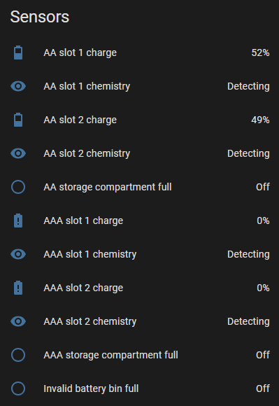

### What the charger actually does (Observed Behavior)
Summary: The Ostation takes about 3 minutes of "probing" a battery (reading voltage and checking chemistry) before it officially flips into an active charging state and reports current/temp telemetry.   You can see the voltages it's reading even when it's not charging.
Cells are physically moved in paired slots (AA and AAA separately). Within a pair, both cells must complete charging before the syste

I got my Ostation 2 last week. Thanks for all your work!
Over the weekend I did some improvements.
Figured out the remaining DP (Data Point) keys:
  • 103: Invalid battery bin full
  • 104: AA storage compartment full
  • 105: Wake sensor sensitivity
  • 106: AAA storage compartment full
  • 113: Always stays zero for me.
Fixed some bugs in the bay telemetry decoding:
  • Bytes 3-4: Charge duration (byte 3 -> hours, byte 4 -> mins)
  • Byte 12: I don't think it is temperature as I regularly get temperatures over 100 °C for prolonged periods, which drops to 24 °C when I put batteries on the other slot. (need more investigation)
  • Bytes 13–16: Zero when charging non Li-ion batteries (maybe it's the 4 byte battery ID, it won't fit anywhere else)

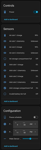

I didn't like the template sensors, so I made the whole thing Tuya Local native:
Things remaining:
  • Figuring out what DP113 does. If somebody has the Pro model, please check if this changes for you when you turn off the screen or do something else.
  • Telemetry for Li-ion batteries. I don't planning to get any, but happy to reverse engineer it if somebody send me one.

I've got an Ostation 2 non-pro and switched over to the now built-in tuya_local support for the Ostation 2 (thanks much to whomever made that happen). My batts charged etc stats got reset but so be it. However that of course messed up the lovely template card posted here that I was using so I "vibe coded" with Gemini a fixed one and thought I'd share. I am using custom bubble cards and button cards so if it dont load for you go grab those from HACS.
title: Ostation Battery Charger
cards:
  - square: false
    type: grid
    columns: 2
    cards:
      - type: custom:button-card
        entity: sensor.office_olight_battery_charger_aaa_slot_1_charge
        icon: mdi:battery
        show_name: true
        show_state: true
        show_label: true
            const ch = states['sensor.office_olight_battery_charger_aaa_slot_1_chemistry'];
            const val = ch ? ch.state : 'unknown';
            if (val === 'Detecting') return 'AAA1: Probing';
            if (['unknown', 'unavailable', 'None'].includes(val)) return 'AAA1: Off';
            if (parseInt(entity.state) >= 100) return 'AAA1: Charged';
            return 'AAA1: Charging';
        state_display: |
            const hEnt = states['sensor.office_olight_battery_charger_aaa_slot_1_charge_time_hour'];
            const mEnt = states['sensor.office_olight_battery_charger_aaa_slot_1_charge_time_min'];
            if (!['Detecting', 'unknown', 'unavailable', 'None'].includes(val)) {
              let out = `${entity.state}%`;
              if (hEnt && mEnt && !['unknown', 'unavailable'].includes(hEnt.state)) {
                let h = parseInt(hEnt.state) || 0;
                let m = parseInt(mEnt.state) || 0;
                if (h > 0 || m > 0) {
                  let tStr = h > 0 ? `${h}h ${m}m` : `${m}m`;
                  out += ` <span style="color: var(--secondary-text-color); font-size: 0.85em; margin-left: 4px;">(${tStr})</span>`;
              return out;
            return '--';
        label: |
            const vEntity = states['sensor.office_olight_battery_charger_aaa_slot_1_voltage'];
            const cEntity = states['sensor.office_olight_battery_charger_aaa_slot_1_current'];
            const chEntity = states['sensor.office_olight_battery_charger_aaa_slot_1_chemistry'];
            let bits = [];
            if (vEntity && !['unknown', 'unavailable'].includes(vEntity.state)) {
              let v = parseFloat(vEntity.state.replace(/,/g, ''));
              if (v > 0) bits.push((v / 1000).toFixed(3) + ' V');
            if (cEntity && !['unknown', 'unavailable'].includes(cEntity.state)) {
              let c = parseFloat(cEntity.state.replace(/,/g, ''));
              if (c > 0) bits.push(c + ' mA');
            if (chEntity && !['unknown', 'unavailable', 'None', 'Detecting'].includes(chEntity.state)) {
              bits.push(chEntity.state);
            return bits.length > 0 ? bits.join(' | ') : '&nbsp;';
        styles:
          grid:
            - grid-template-areas: "\"i n s\" \"i bar bar\" \"l l l\""
            - grid-template-columns: 36px 1fr min-content
            - grid-template-rows: min-content 10px min-content
          card:
            - padding: 12px
            - border-radius: 12px
            - background: var(--card-background-color)
          name:
            - justify-self: start
            - font-weight: 500
            - font-size: 14px
          state:
            - justify-self: end
            - font-size: 14px
          label:
            - font-size: 11px
            - color: var(--secondary-text-color)
            - margin-top: 8px
          icon:
            - width: 24px
            - color: |
                  const val = parseInt(entity.state) || 0;
                  if (val >= 100) return 'var(--success-color, green)';
                  if (val > 0) return 'var(--warning-color, orange)';
                  return 'var(--disabled-text-color, grey)';
        custom_fields:
          bar: |
              let val = parseInt(entity.state) || 0;
              if (!ch || ['Detecting', 'unknown', 'None'].includes(ch.state)) val = 0;
              let color = 'var(--primary-color)';
              if (val >= 100) color = 'var(--success-color, green)';
              return `<div style="background: rgba(150,150,150,0.2); border-radius: 4px; height: 6px; width: 100%; margin-top: 2px; overflow: hidden;">
                        <div style="background: ${color}; height: 100%; width: ${val}%; transition: width 0.3s ease;"></div>
                      </div>`;

here's a screenshot.
Post back any improvements you guys make. Oh sorry for the device name not being "default". You guys will have to find/replace a bunch of entity_ids to match yours. :frowning:

I did just order some of the actual Ostation branded Li-Ion AAs. They’ll come in soon. They are actually a pretty decent price point and not bad capacity for Li-Ion. Due to how proprietary the Li-Ion situation is these are I think the only Li-Ion batts this thing will charge but fortunately they aren’t a rip off. But I can maybe see how the codes change when charging those. Seems the raw device output string is no longer a sensor though so you’ll have to let me know how to see that data again.
Does not appear to be detecting the Li-Ion AA battery chemistry properly.
Update:
Downloaded the diagnostic data and I think this is what you’d need to figure out how the Li-Ion chemistry reports right?
  "data": {
    "name": "Olight Battery Charger",
    "type": "olight_ostation_2_battery_charger",
    "device_id": "**REDACTED**",
    "device_cid": "",
    "local_key": "**REDACTED**",
    "host": "**REDACTED**",
    "protocol_version": 3.5,
    "tinytuya_version": "1.20.0",
    "api_version_set": 3.5,
    "api_version_used": 3.5,
    "api_working": true,
    "status": {},
    "cached_state": {
      "updated_at": 1783565795.9692538,
      "101": true,
      "102": 5,
      "103": false,
      "104": false,
      "105": 3,
      "106": false,
      "108": 0,
      "111": false,
      "113": 0,
      "110": "AwI5ADYAAGQO7icAMyIFhekEAjUANgAAZA7KJwA0IgZnmAEAAAAAAAAAAAAAAAAAAAAAAgAAAAAAAAAAAAAAAAAAAAA="
