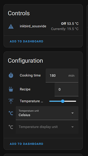

It’s possible the integration may have been tweaked, but all these controls should be easily accessible once integrated via tuya_local. No special configuration required.
This is what is in the device information once integrated:
clicking into the ā€œcontrolsā€ section yields this:
Basically, it’s a thermostat in HA. You can integrate it into dashboards however you’d like.
