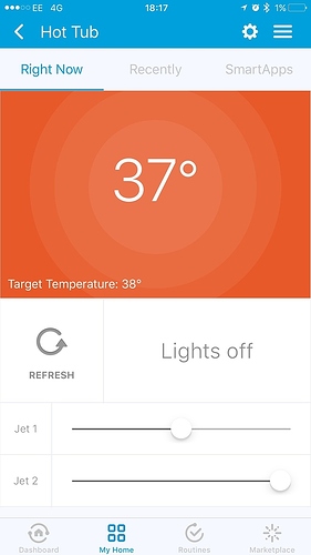

To the OP, there is a very long and interesting thread on smartthings regarding the BWA / wifi controller for balboa, and it looks like recently a smartthings handler has been created. I haven’t played with it yet (I have the CMA system, but probably going to swap in the wifi module instead), but might be worth a read.
