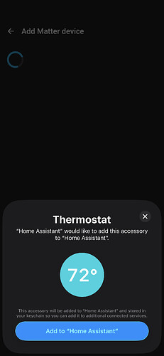

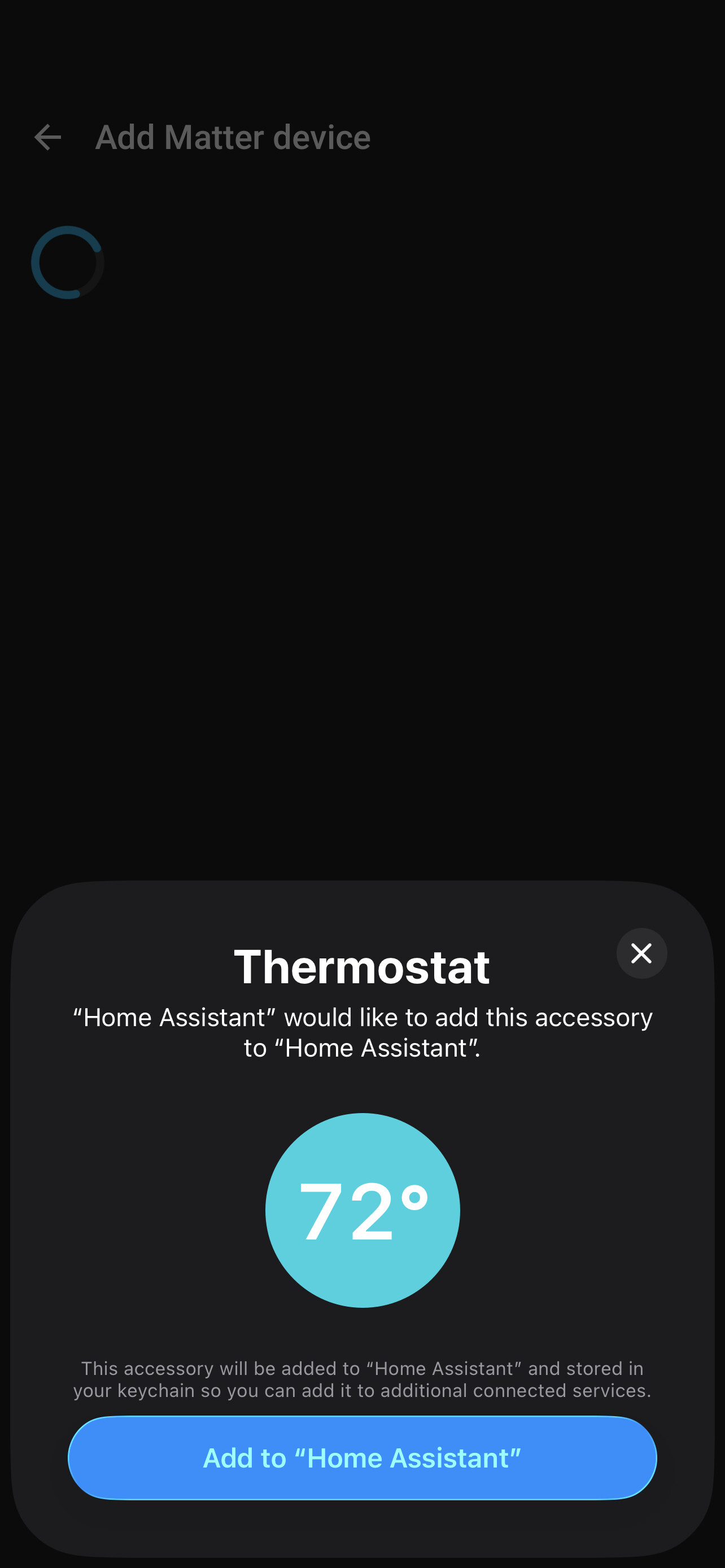

I just got off the Phone with support, they had me reboot the unit ( to force an update ) even though I had the add to Matter button, but this time I got it to detect that it was a thermostat. Unfortunately it still just timed out with an unable to add accessory.
