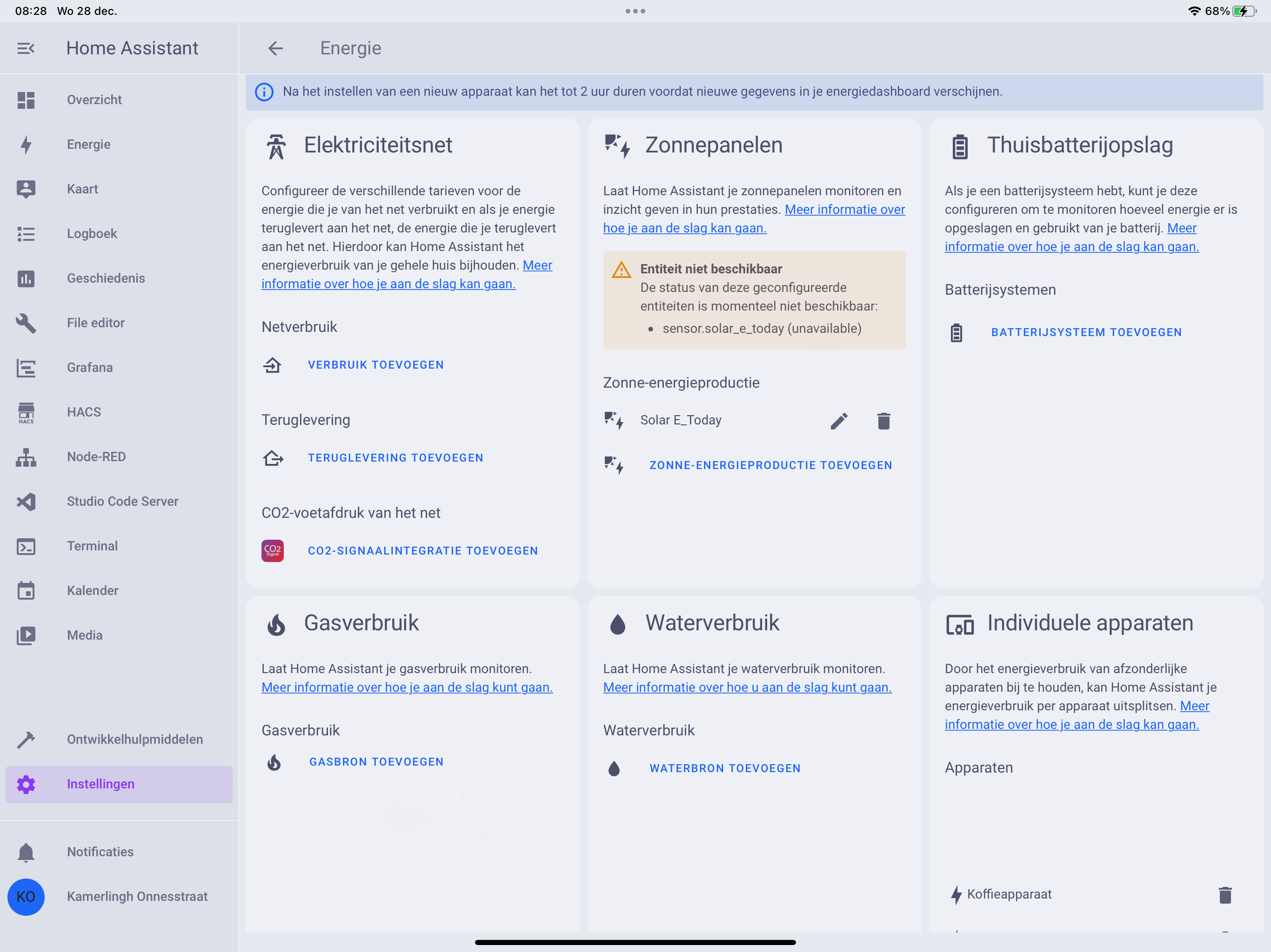

to start with i recopmend you remove all but your soler system from the " Solar production" section of the dashboard settings
if you can post a screenshot of your dashboard settings so we can get an idea of what is there that would help too
I removed everything from my dashboard except the solar entity. Here are the screenshots. I don’t have the freedom in this dashboard to create one similar to yours. I like your graphics in the top left corner.

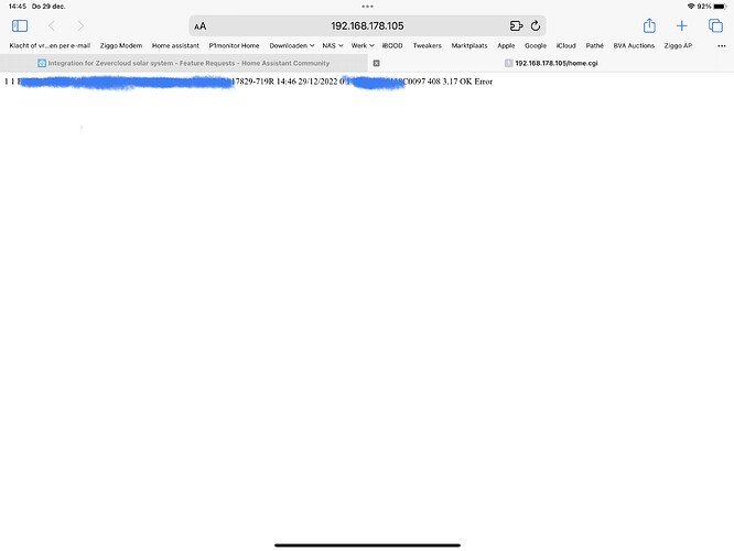

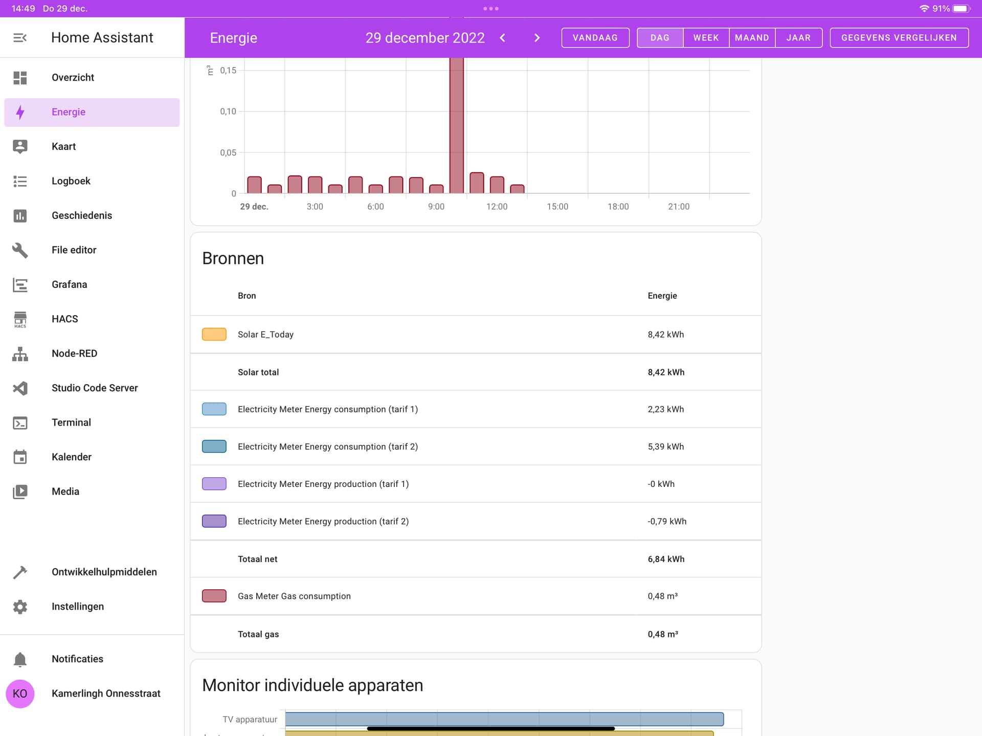

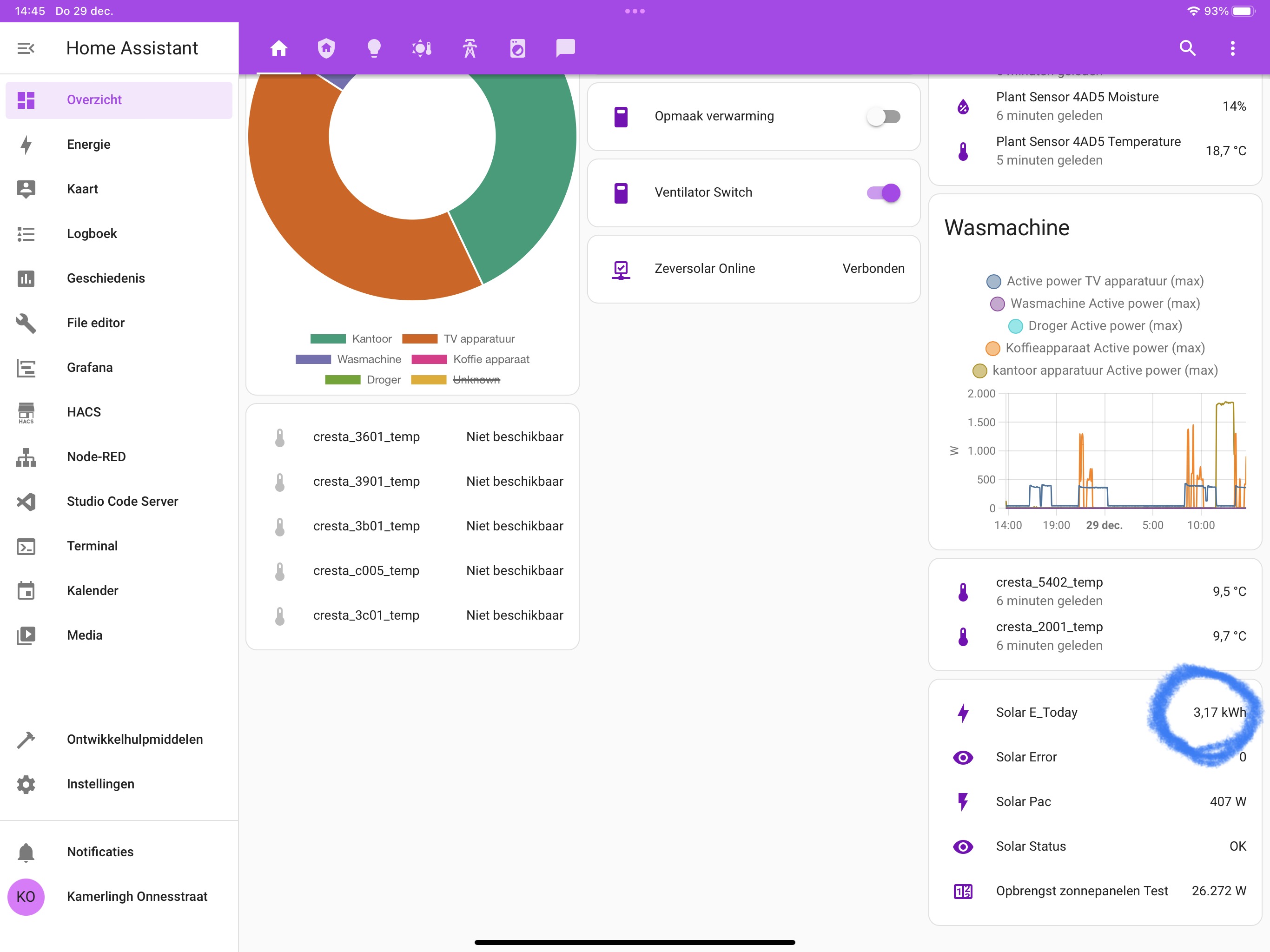

Update: I do see now that the e total is the same as the solar yield. So probably the energy meter production was added to the solar yield. Only it is still too high when I compare the value to home.cgi value.
Hi. Maybe someone else that is mentioning the same issue has a fix for me.
oh so the raw sensor value dosnt match home.cgi? i thought you said it did

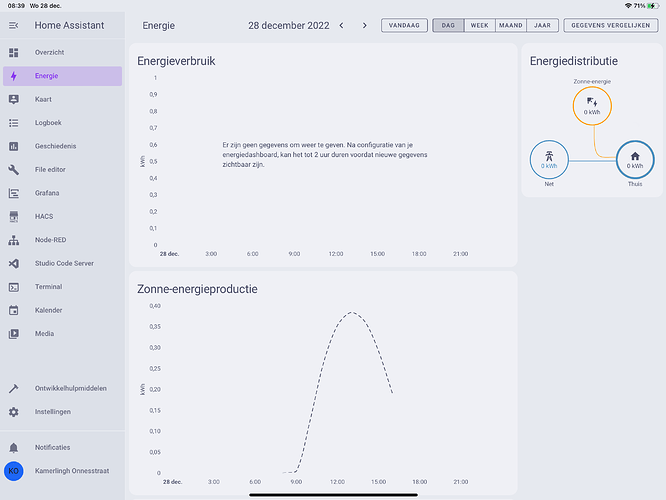

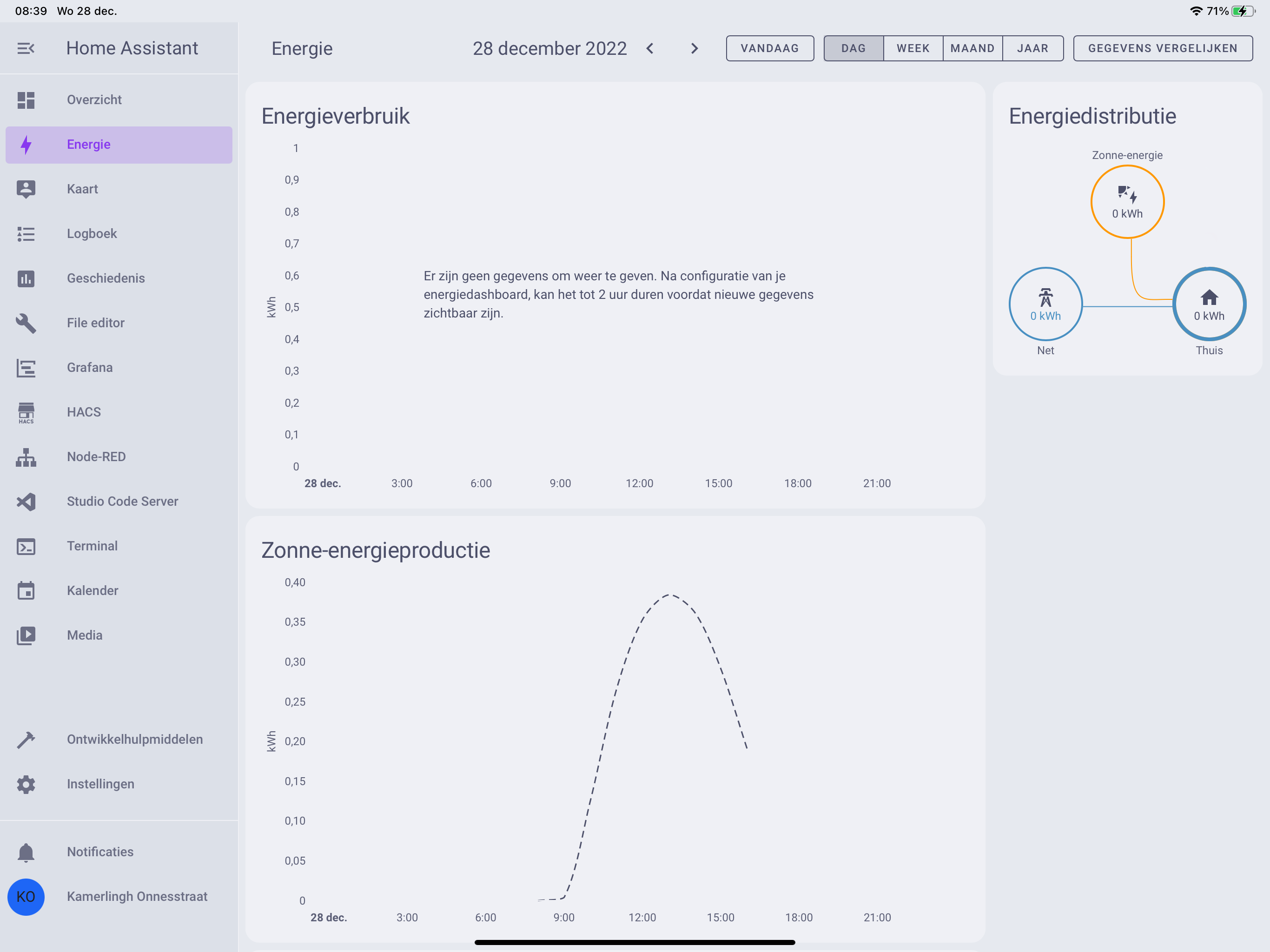

I tried deleting everything from the yaml. Restart and add the code to the yaml again. Still no luck. The sensor e Solar today shows the correct value in my dashboard.
However the same sensor in the energy dashboard shows a totally different value.
