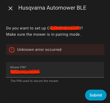

I am trying to add my Husqvarna Automower 310 Robot via Bluetooth via the “Husqvarna Automower BLE” integration.
I enter the Mac address as requested and start pairing the robot. It searches non-stop, never stopping. However, the robot indicates that it’s connected, and the Bluetooth monitor via HA indicates that the robot is connected, but no entity is added.
What should I do?
Thx

3
I tried to pair the Husqvarna 310 mower, but it kept failing (just failed or unknown error occurred) or spinning for a long time. Have you found a solution that works?
