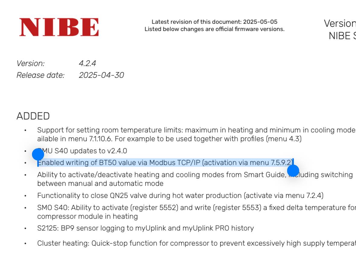

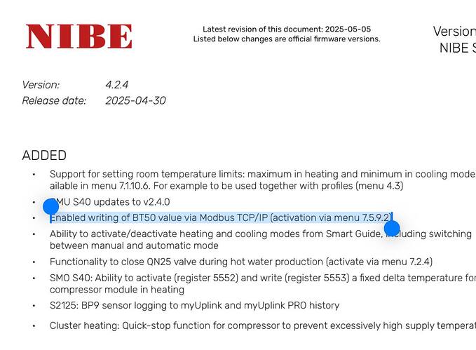

Seems like you also should be able to SET the BT50 value after latest update to S series? Any chance to implement this feature?
Interesting … would allow other sensors to be used as input for room temperature.

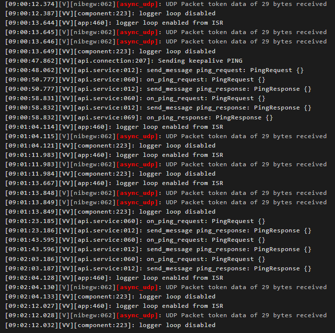

Anyone know if this can work with a Nibe F2025? I have a Elfin EW11 modbus tcp adapter. And connected it to A+ & B- but not getting anywhere with communications.
I have now tried installing a ESP32 with a MAX485 module. Grok tried to make the code, but only getting this in my logs and I am not able to connect to the NIBE Heatpump in Home Assistant:
