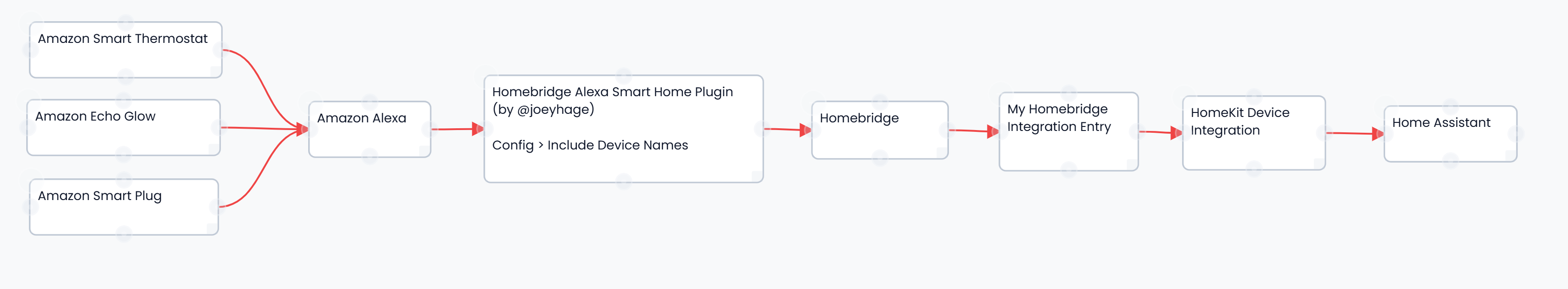

If anyone is trying to integrate Amazon Smart Thermostat, Amazon Echo Glow, or Amazon Smart Plug into Home Assistant, here is a basic chart of what has worked for me. Home Assistant entities are climate, sensor, select for the thermostat; light for the glow; switch for the smart plug.
:bulb: Stability Note: Homebridge Alexa Smart Home Plugin
The plugin is generally stable, but it occasionally loses connection to the Amazon Account and requires re-authentication.
I haven’t found a pattern for this drop yet. The next time the connection is lost, I plan on looking for a way to set up a detection system in Home Assistant to notify me immediately when the failure occurs, instead of waiting until I notice it’s broken.
how to install the plugin ? what is the name ?
See the section called “Install Homebridge” within the following:
I installed on Raspberry Pi 3 using instructions here:
Then browse to http://YourHomebridgeHostIPAddress:8581/plugins
Search for “Homebridge Alexa Smart Home” by @joeyhage to install the plug-in
Follow: GitHub - joeyhage/homebridge-alexa-smarthome: Connect Alexa devices to HomeKit
Add your Amazon devices using the Plug-In.
Back in Home Assistant, install the integration called “HomeKit Device” which supports HomeBridge
Home Assistant will then find your Amazon devices
