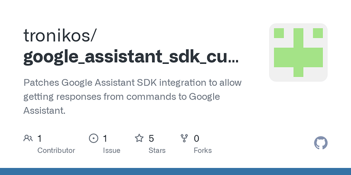

Is it possible to do that. I have it set up but looking at the Home Assistant integration for Google Assistant SDK I didn’t see how you could parse the response.
To get and parse the responses you can install:
