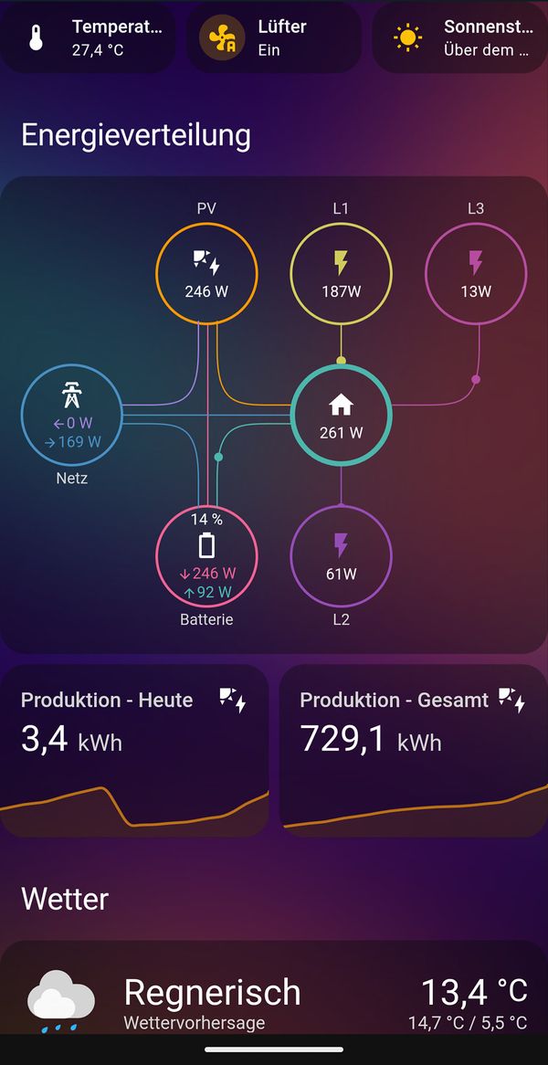

After much back and forth, I managed to integrate the PV input and SOC from the BK215 into the HA :raised_hands:t3: It’s not perfect, but at least I have data in the HA every few minutes. It’s controllable, of course…

Finally, a few excerpts of what’s possible and how it’s implemented.
Feel free to post examples here; I’m stuck for it otherwise, but together we’ll get it done. Sunlit has been promising and not delivering for long enough.

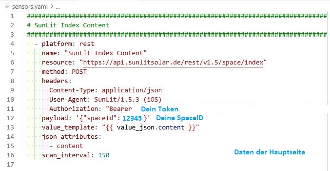

REST-Sensor:
sensor:
  - platform: rest
    name: "SunLit Index Content"
    resource: "https://api.sunlitsolar.de/rest/v1.5/space/index"
    method: POST
    headers:
      Content-Type: application/json
      User-Agent: SunLit/1.5.3 (iOS)
      Authorization: "Bearer Dein_Token"
    payload: '{"spaceId": deine_spaceId}'
    value_template: "{{ value_json.content }}"
    json_attributes:
      - content
    scan_interval: 150

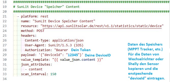

  - platform: rest
    name: "SunLit Device Speicher Content"
    resource: "https://api.sunlitsolar.de/rest/v1.1/statistics/static/device"
    method: POST
    headers:
    payload: '{"deviceId": "deine device_ID"}'
    json_attributes:
      - content
    scan_interval: 150

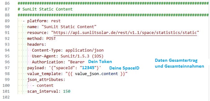

  - platform: rest
    name: "SunLit Static Content"
    resource: "https://api.sunlitsolar.de/rest/v1.1/space/statistics/static"
    method: POST
    headers:
    payload: '{"spaceId": "deine_spaceId"}'
    json_attributes:
      - content
    scan_interval: 150

For the sensors under Device List, these would probably require separate API calls, e.g., …/device/list
yes exactly! The endpoint https://api.sunlitsolar.de/rest/v1.5/space/index only returns a summary for one space (site), and that’s where the current REST sensors get their data from.
If you’re looking to access detailed per-device data (like individual inverters, batteries, heaters, etc.), then you’re right you’ll likely need to call another endpoint.
You can watch for requests in mitmproxy while you interact with the app especially when you tap on specific devices, view detailed performance graphs, open the “Device List”
That usually triggers additional API calls that might return more data, historical performance, per-device statistics, etc …

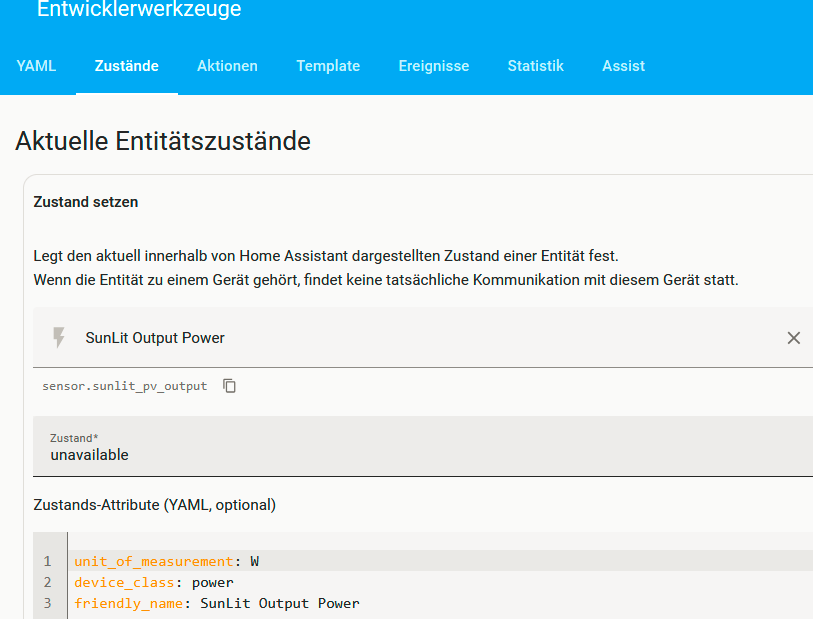

I’d recommend only integrating the REST sensor first, without any template sensors.
Then go to Developer Tools → States in Home Assistant and check if the sensor (e.g. sensor.sunlit_bk215_soc) appears and contains data.
Once that’s confirmed, you can safely build template sensors based on the available attributes without guessing or fighting with YAML errors.

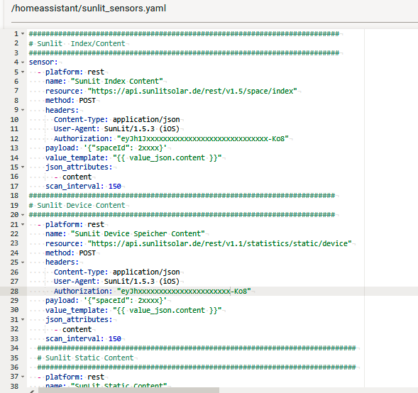

So:
Created sunlite_sensors.yaml and implemented it there as per the forum
index content
device storage content
statistic content
; the YAML editor was also satisfied with it. (green dot)
However, there’s still a warning in the config check:
Invalid config for ‘sensor’ at configuration.yaml, line 120: required key ‘platform’ not provided
Line 120 is the link to sunlit_sensor.yaml
sensor: !include sunlit_sensors.yaml
I’ll stop there for now, thanks for your patience.

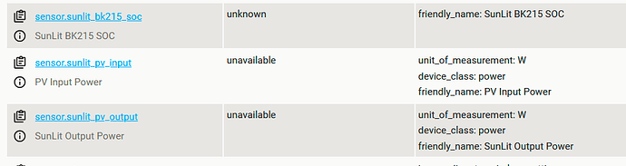

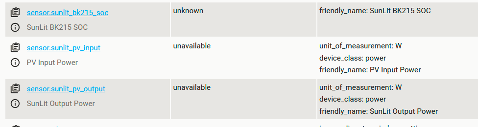

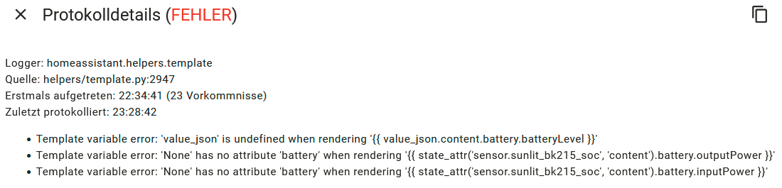

The following error message isn’t helping me.
First of all, I’ve only created these sensors three times.
grafik

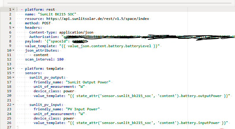

Now the “example: setup sunlit_sensors.yaml” worked. It started without errors, and the corresponding entities are being created. However, they still have no values. Unknown or zero watts. Where can I see the JSON data of the queries in HA?
Logger: homeassistant.helpers.event
Quelle: helpers/template.py:646
Erstmals aufgetreten: 21:33:36 (2 Vorkommnisse)
Zuletzt protokolliert: 21:33:36
EdiT:
Now I've found a configuration that's at least valid, and it also creates a sensor and two templates. However, I'm still not happy with it; the measured values ​​aren't displayed for some reason. All the logger settings that were offered as help were apparently not allowed for sensors. Well, I haven't given up yet.
Error while processing template: Template<template=({{ state_attr('sensor.sunlit_bk215_soc', 'content').battery.outputPower }}) renders=2>
Error while processing template: Template<template=({{ state_attr('sensor.sunlit_bk215_soc', 'content').battery.inputPower }}) renders=2>

jinja2.exceptions.UndefinedError: 'None' has no attribute 'battery'
  File "/usr/src/homeassistant/homeassistant/helpers/template.py", line 761, in async_render_to_info
    render_info._result = self.async_render(  # noqa: SLF001
        variables, strict=strict, log_fn=log_fn, **kwargs
  File "/usr/src/homeassistant/homeassistant/helpers/template.py", line 646, in async_render
    raise TemplateError(err) from err
homeassistant.exceptions.TemplateError: UndefinedError: 'None' has no attribute 'battery'
Check if the REST sensor is receiving data
Steps:
  1. Go to Developer Tools → States in Home Assistant.
  2. Look for your sensor, e.g.
  3. Look at the Attributes on the right:
    • Do you see an attribute called content?
    • Does it contain actual values like batterySoc, battery1Soc, etc.?
If it says content: None, the API is not returning data — possibly due to an invalid token or space ID.
Enable API Debug Logging
To see if the API request fails (e.g. 401 Unauthorized), enable debug logging:
In your configuration.yaml:
logger:
  default: warning
  logs:
    homeassistant.components.rest: debug
Fixing Template Sensor Errors
If you see errors like:
It means your value_template is trying to access something that doesn’t exist yet.
Example of a failing template:

Hey, first of all in order to make sure you dont have to blackout the key evertime you can use and
    headers:
      Authorization: !secret sunlit_token
and in the secrets.yaml file you need to add:
sunlit_token: "Bearer ey...DA"
Furthermore, I have integrated the MPPTs myself and noticed that the payload needs to include the following:
    payload: '{"spaceId": 99999, "deviceId": 99999}'
so my new sensors.yaml looks like this:
  - platform: rest
    method: POST
    headers:
    payload: '{"spaceId": 99999}'
    value_template: "{{ value_json.content.battery.batteryLevel }}"
    json_attributes:
      - content
    unit_of_measurement: "%"
    scan_interval: 180
  - platform: rest
    method: POST
    headers:
      Authorization: !secret sunlit_mppt_token
    value_template: "{{ value_json.content.batteryMppt1Data.batteryMpptInPower }}"
    json_attributes:
      - content
    unit_of_measurement: "W"
    device_class: "power"
    scan_interval: 180

Your errors indicate that either:
  1. The REST API is not returning data
  2. The template is accessing attributes that don’t exist
To verify what you’re actually getting back from the API:
Go to:
Developer Tools → Templates
Enter this:
{{ state_attr('sensor.sunlit_bk215_soc', 'content') }}
  • If it returns None, the API call failed or returned no JSON
  • If it returns a dictionary, check what keys exist – e.g. batterySoc, inputPowerTotal, etc.
Hey,
that was the cause, and since I couldn’t verify the result, I was groping in the dark.
I couldn’t imagine that the word “bearer” belonged to the token. Which annoys me, though, because I had also seen that as a possible error, but forgot to ask.
grafik
Edit:
Very cool. A dream. I’m sure I can manage the rest with the templates. I hope this tip helps others too. Thank you so much again.

so i love my updatet Awtrix Pixelclock:
ergebnis-awtrix
