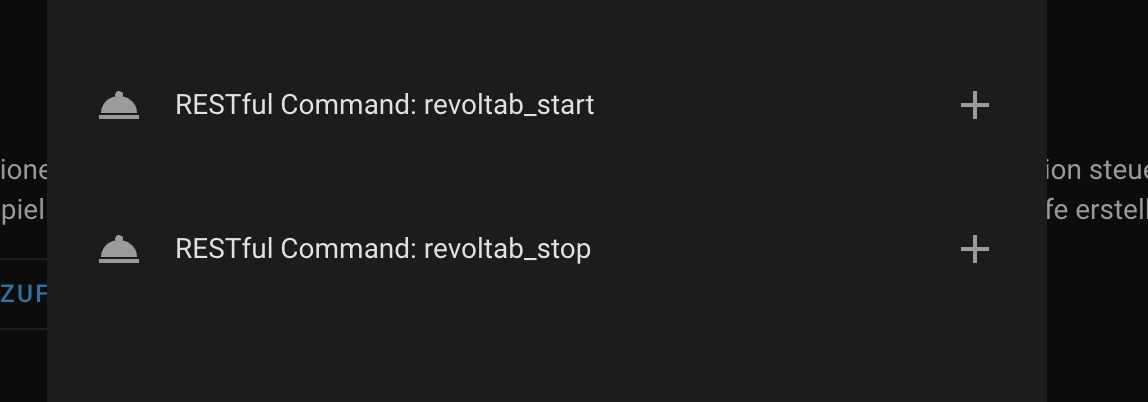

Something like this should then be working with rest commands (In configuration.yaml, restart required):
rest_command:
  revoltab_start:
    url: "https://backend.revoltab.com/api/v1/startdevice"
    method: post
    headers:
      authorization: "Bearer INSERTYOURAPIKEYHERE"
    content_type: "application/x-www-form-urlencoded"
  revoltab_stop:
    url: "https://backend.revoltab.com/api/v1/stopdevice"
    method: post
    headers:
This is just a quick draft and as I don’t have the device myself, I couldn’t test it properly. You should also consider moving the authorization key to secrets.
After this you should be able to use them in automations to start/stop the device
Maybe this helps someone (:
