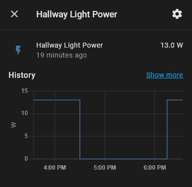

I have a simple light named Hallway Light:
I know that this light uses 13 W of power when it’s on, and 0 W when it is off, so I created a template sensor to reflect its power usage:

This works well, except for one issue: the value of the integration sensor only updates when the value of the source (power) sensor changes. If I turn on my light for 12 hours, the energy usage of the light is not gradually added to the total kWh value during those 12 hours like I would expect. Instead, it is all added to the total immediately when I turn the light off. I have daily and monthly utility_meter sensors and this issue causes the energy usage to be added to the wrong day or month. Is there a way to make the integration sensor update in real time (or even on an interval, say, every 5 minutes), so that it will always accurately reflect the amount of energy that my light has used?
