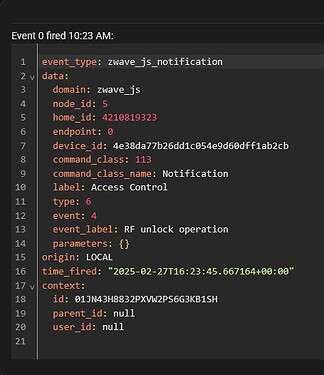

My Question: How can I react with an automation (script) on this notification?
How is the right YAML description?
This is what the device show in my script for example
triggers:
- device_id: df245c70f0d0f70469843f7d456456
domain: zwave_js
type: event.notification.entry_control
command_class: 111
trigger: device
But I don’t know how I can integrate the event or type from protocol. I’m a little bit lost…
