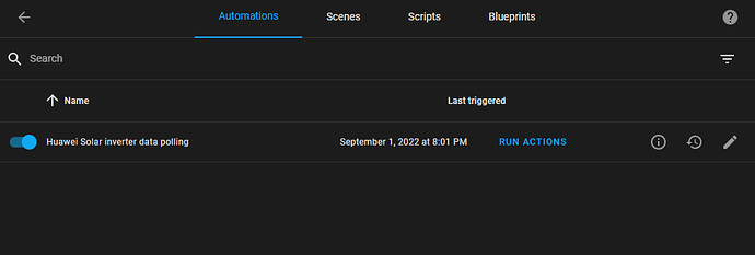

Hello to all
I’ve just installed a SUN2000-4KTL-L1
my question is (and others more)… where to place this?
- alias: "Huawei Solar inverter data polling"
trigger:
- platform: time_pattern
hours: "*"
minutes: "*"
seconds: "/10"
action:
- service: homeassistant.update_entity
entity_id: sensor.daily_yield
Also another question
when battery is 100%, the “inverter active power” value changes to the “input power” from solar panels
with this, i can’t know what is beeing used to power the house
how can i get the “load” from house?

Same here bro. Did you got any solution for this?
I just put it manually in automation page
Done!
Hope this help!!
