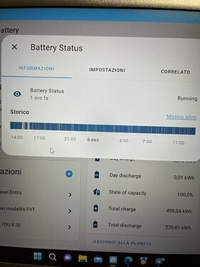

@wlcrs
do you think RS485 connection is more reliable than a wiredDongle as @manio say in his post ?
I have a wired Dongle, why even if i have setted up a polling time of 30s , i have some fetching error from data update coordinator ?
gist:252688eff820f0d7aaf7e3b458dd90ed (github.com)
it’s really annoiyng because the integration stop to work a lot of time during a day as you can see here, that’s normal ?
I’ve noticed that sometime i lost the connection to the remote management system (from SUN2000app ) but that’s not related to my connection that i constantly monitor…in your opinion, that can be related to my fetching errors?
I’m also refering to @unglazedswansea and @xploss with their post
I have no opinion on this as I do not own an SDongle and do not use the serial pins to connect to my inverter in practice.
Note that you cannot use the serial pins and the SDongle at the same time: there are several reports of constant interruptions of the serial connection in that case.
