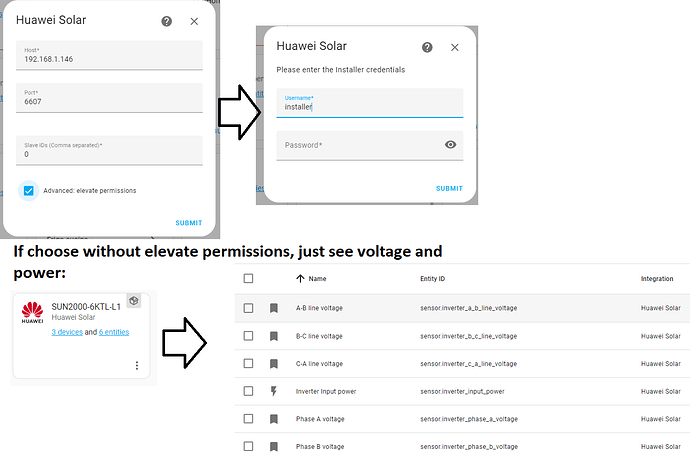

At the end I’m able to put the inverter in the network by following the same method of dados1988:
In the HA Huawai Integration (downloaded from HACS) I put the IP of the bridge Tp-Link Tl-Wr802N :6607, and it successfully redirects the connection to 192.168.200.1:6607
Compared to dados1988 I’ve just change ip to my network: 192.168.1.146
And of course I’ve insert SN and MAC of my inverter.
Honestly, initially it didn’t connecting to the inverter (from the web interface of the Tp-Link Tl-Wr802N, under “overview” menu, it shows disconnected from S2000) . I had do connect it via the web interface. After that I’ve placed again the config parameters via WINSCP. Rebooted the Tp-link, and the connection works well.
But… see the picture below :frowning:
I don’t know why, but I was supposing that in this process it doesn’t need to apply any password. My fault…!
Without choosing “elevated permissions” I can acquire only power and voltage (not the battery status information)
EDIT: Wait wait wait, real time update!
There were like 3 entities disabled, with “like-not-useful” description, but once activated magically it shows more than 50 active entities :star_struck:
See picture:
Tip: For a windows user like me it was tricky to set-up openwrt, but I’ve found useful the application “winscp”, which permits to modify the setting files without use the command line! Once opened the connection you have just to go throw the folders and copy/paste the setting described by dados1988 (just modify something according with your network 192.168.1.146 SN and MAC of my inverter)
