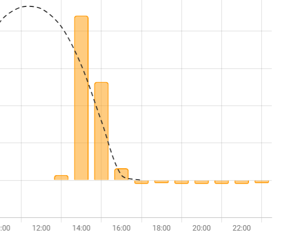

Did you solve your problem of the result of the calculation giving negative solar energy at night?
template:
  - sensor:
    - name: "energy_pv_daily"
      unique_id: "PV Energy daily"
      state: >
        {{ (states('sensor.inverter_daily_yield') | float) - (states('sensor.battery_1_rozladowanie_dzienne') | float) + (states('sensor.battery_1_ladowania_dzienne') | float) }}
      device_class: energy
      state_class: total_increasing
      unit_of_measurement: 'kWh'

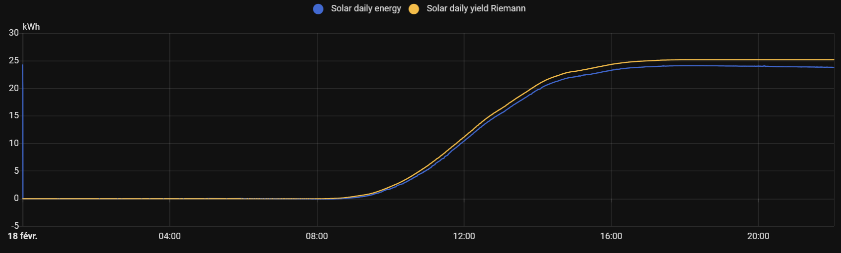

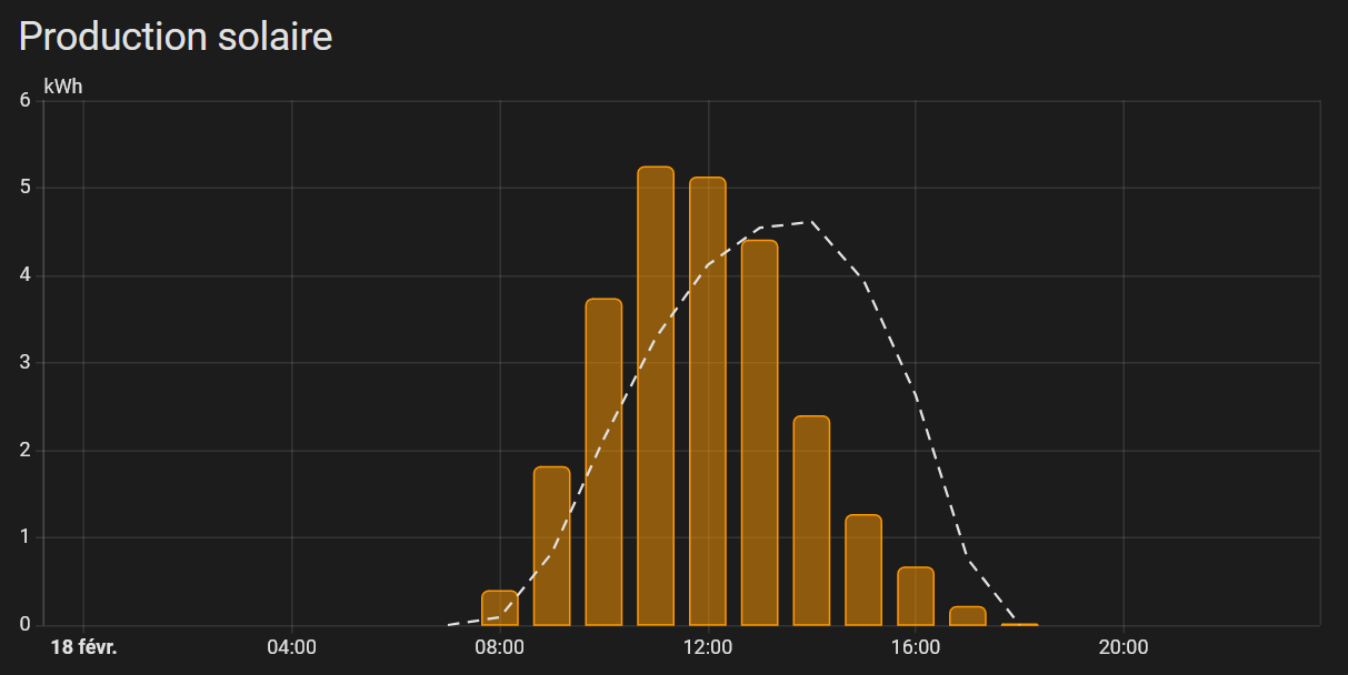

A way to solve this is to recompute solar power from current and voltage
And then integrate the value to have kWh, for example with this add-on:
In configuration.yaml:

solar power integral compared to calculated energy from ā€œsolar daily energyā€ in the yaml
Integral is a bit higher since it’s before the inverter efficiency
No negative value, no dirty graph when battery charge from grid, no midnight spike when reset is at 00:01
