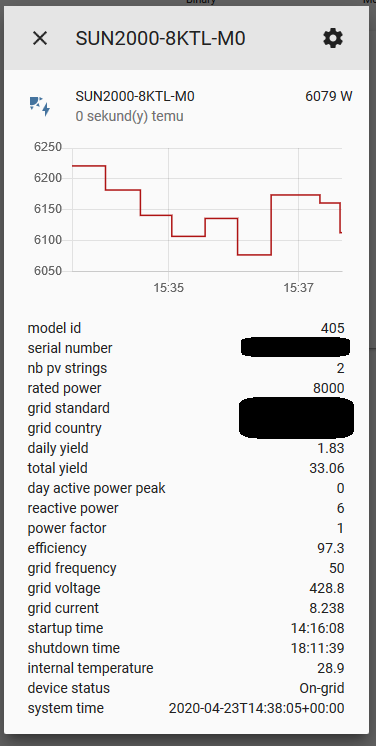

It’s not grid voltage, but voltage between L1 and L2. It’s working now, after I commented lines with optimizers in sensor.py. Inverter have L1, L2 and L3 so I will need some modification. Now I know how to do it. Thanks for your help.
