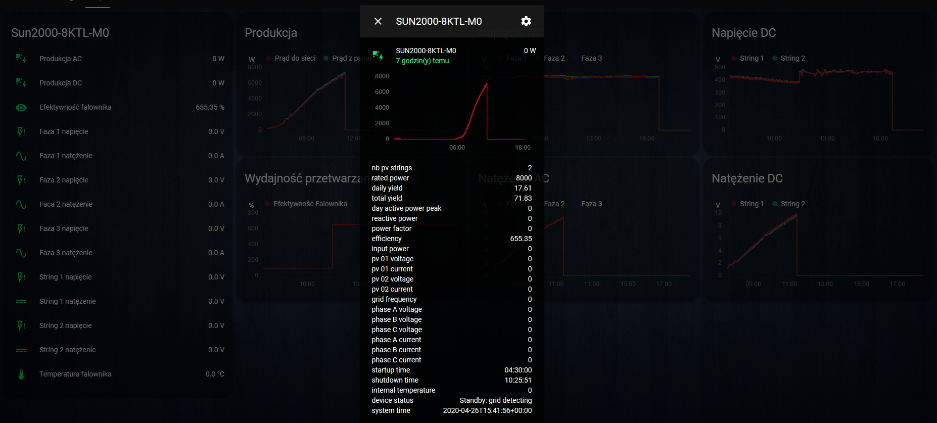

Hi there guys. Impressive skills you show here I must say. I have some experience with Python and running OctoPrint in my Pi (for 3D printers), but I’m inspired by your work. I’d like to mimic your stuff to connect to my SUN2000 8KTL M0 (software version V100R001C00SPC120). Rafal explained connecting to the wifi dongle using a router as a gateway. So you are not using a RS485 cable from inverter to USB into Pi? So do I need an extra router for that?
Yes that’s right. I’m not using any cable. I’m connected wireless to SUN2000 8KTL M0. The extra router is used because my inverter is in garage and for this integration you must be directly connected to internal sun2000 wifi (192.168.8.1). If it is possible to connect to Pi wifi adapter and you are in range of inverters wifi, then you do not need extra router.
My integration
