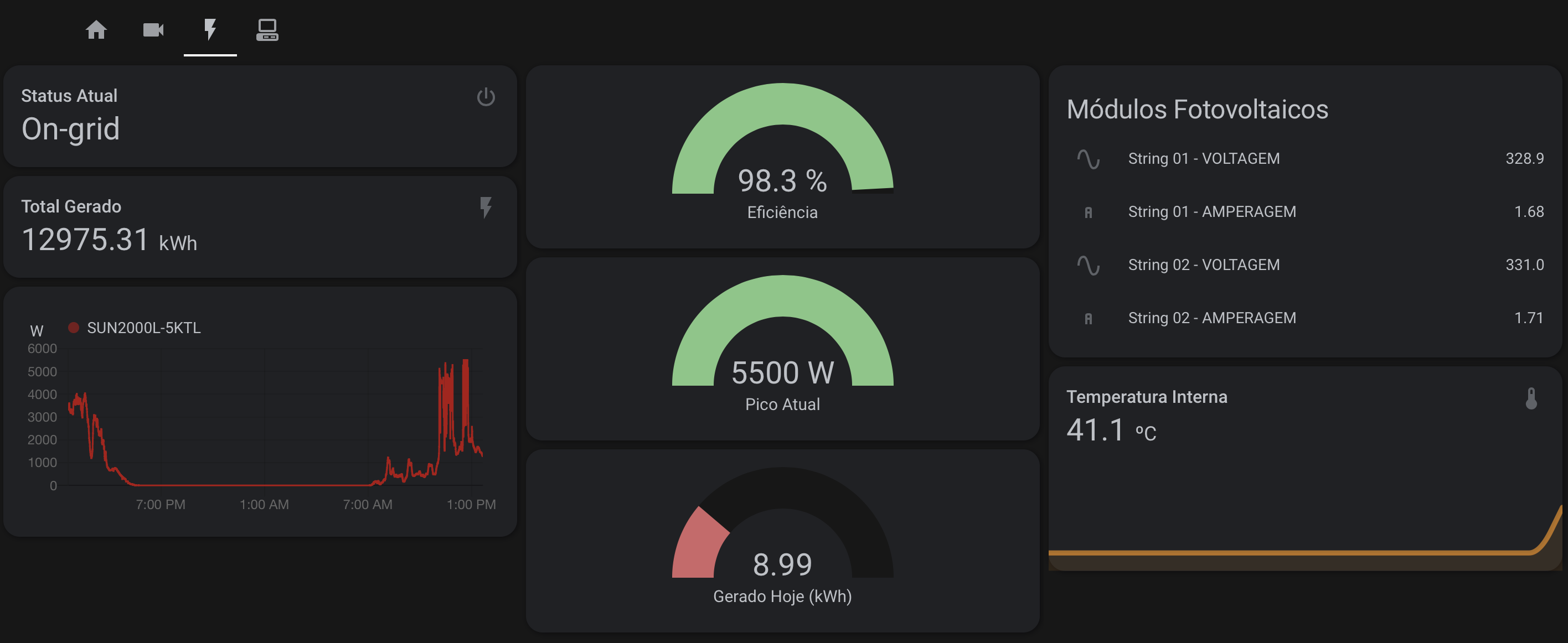

Thank you @Emilv2! Here how it looks like right now :heart_eyes:
@ligeza, well done, beautiful cards configuration! How did you manage put the “image” of the lines with the inverter, strings, and so on?
I used https://www.home-assistant.io/lovelace/picture-elements/ .

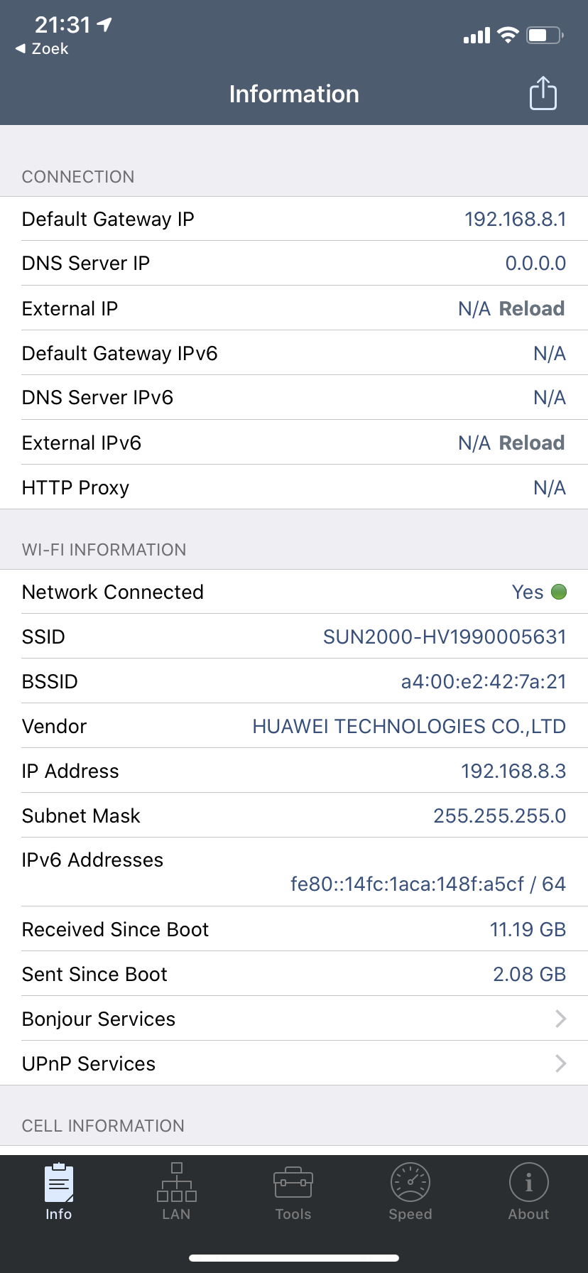

Indeed Rafal, I have two connections. One on Ethernet cabled home network and a wlan to inverter WiFi.
Don’t have the nmcli screen print here, but the IP details match the one I got on my iPhone when connected to the SUN WiFi and ran Net Analyzer app. Gateway is at 192.168.8.3 and WiFi is at 192.168.8.3.
From screenshot I see that gateway is 192.168.8.1 so you should use this IP in configuration.
  - platform: huawei_solar
    host: '192.168.8.1'
192.168.8.3 is IP given to your Iphone.
