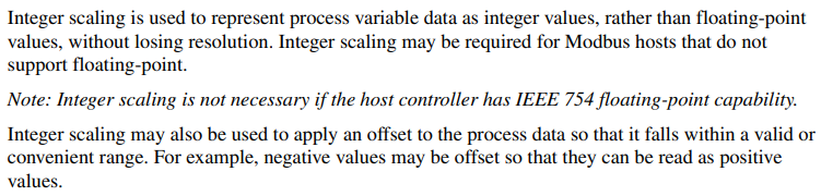

In this respect, the resolution aimed by huawei is 0.001 kW, or indeed 1W.
I was puzzeled how @MicheleMercuri was able to have a 5012,7W indication…
If you are reading the register is Watt then it should be a Integer, if you are reading it in kW then it should be a float with precision 3, no ?
