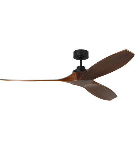

Are you also using a Maverick? They suggested they have a Smart Fan that’s similar to the Maverick called the Collins (Also a DC fan), and was thinking about making an attempt to buy their receiver / remote to see if it wold work.

@GoodyGizmos is the Monte Carlo fan that’s supported the Collins model?
From Googling the Collins fan, it’s definitely a different model. Here’s the FCC search I did - Supported Devices | Bond.

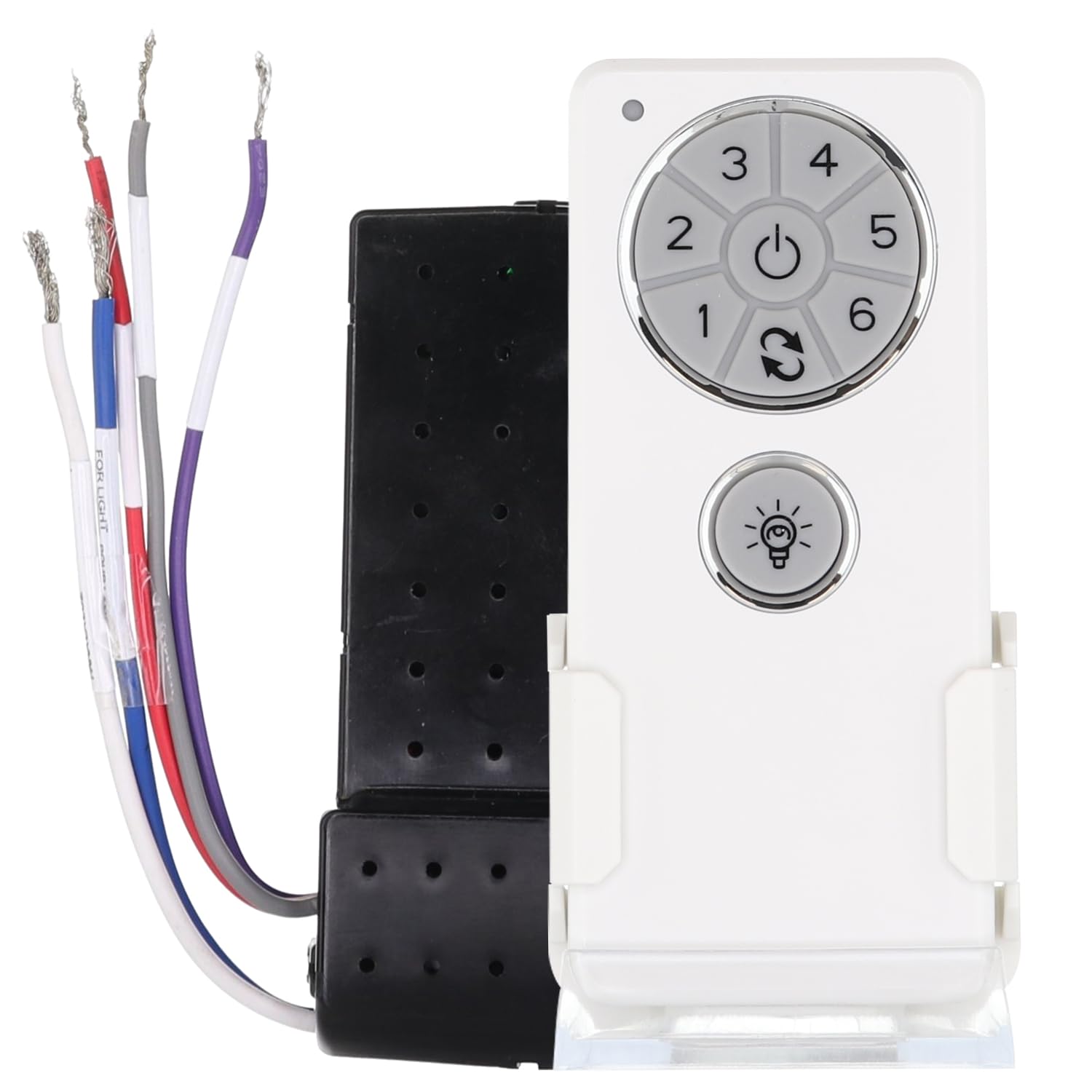

Have you (or anyone else) happened to find a way to easily replace the remote? It seems very hard to find. I got a saved search on eBay since it has apparently been sold there before but not sure if there’s a reliable supply.
Why I ask: I actually just took apart the remote and it seems trivial to short the buttons to trigger the appropriate RF signal. Would require some soldering, software and etc to properly maintain state and all so that’d be an interesting project. I figured if I wanted to turn that into a project, I’d want an extra remote or two not only for backup but for convenience when actually in the room using it and not wanting to use voice or other smart home control per se.
Edit: You can get the part from them directly by calling 1-800-969-3347. I see the part for my fan listed online at “Light Trends”, so that’s another option maybe.

I have been searching for a fix to this issue as well. Has anyone tried using this replacement Monte Carlo receiver? It seems like the remote operates on 315 mhz which I believe would work with a Bond controller.
I wanted to check if we’re dealing with the same remote here. After some research, I believe the remote in question is the Pan-World Control Technologies Model 7RC04-CF100001 (FCC ID: R8Y7RC04-CF100001).
