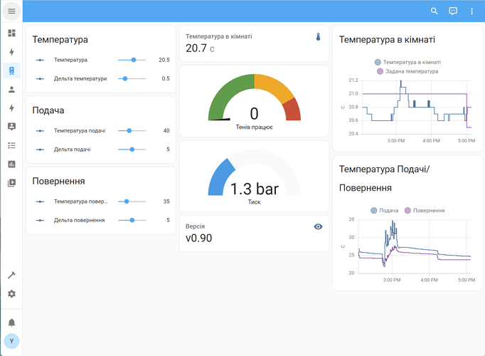

I was able to integrate with Tenko using existing means:
For example sensor definition for Water Feed temperature and Delta:
- scan_interval: 60
  headers:
    Authorization: !secret tenko_secret
  resource: https://my.tenko.ua/api/v1.2/smart/full_data
  sensor:
    - name: "tenko_settings_water_feed"
      unique_id: "tenko_settings_water_feed"
      value_template: "{{ value_json.settings.WF.temp }}"
      device_class: temperature
      unit_of_measurement: C
    - name: "tenko_settings_water_feed_delta"
      unique_id: "tenko_settings_water_feed_delta"
      value_template: "{{ value_json.settings.WF.delta }}"
So far I’ve tried basic functionality. The result looks like this:
