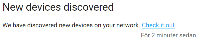

Just removed my MinutPoint integration after having problems a couple of months and restarted HomeAssistant and got a notification:

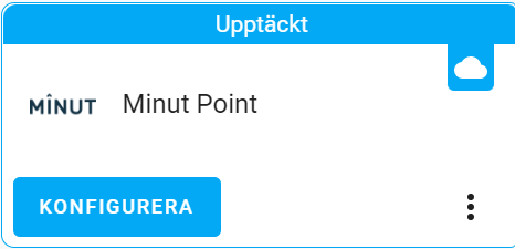

and it looks like it discovered the integration again!?
Tried to click configure but it looks like there's an error:
but nothing happen clicking it!```
```F.Y.I. Testing to call the link: http://homeassistant:8123/api/minut
downloads a file "minut" with the text "OK!"
Guess I've been missing some step? Please help!
///Peter
