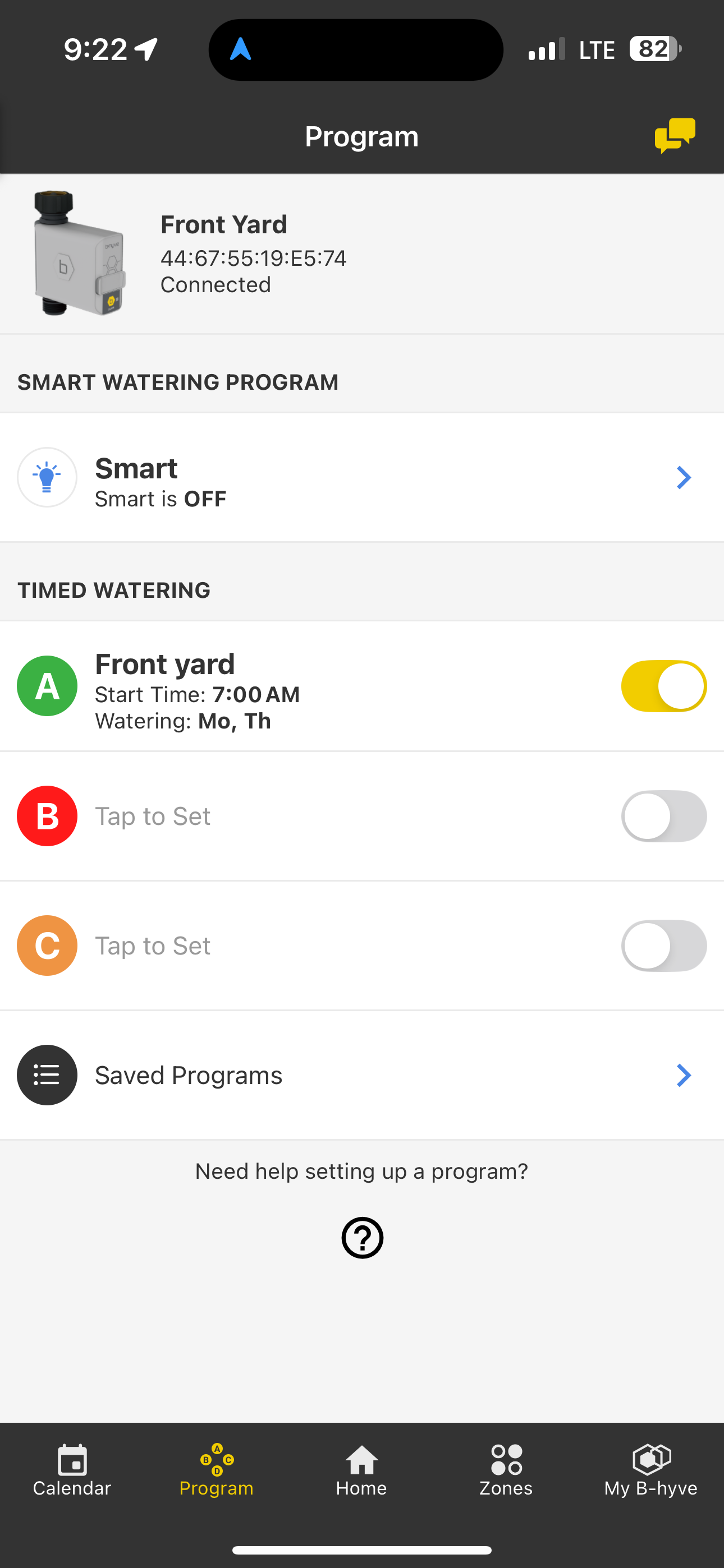

Anyone know why, when running a program, the zone switches on then immediately off? The program runs, it’s just the zone switch in HA that turns off immediately. I have some other things within HA that are triggered by that switch being on, but get shut off immediately.
On the B-Hyve app disable smart watering for the zone.
It is off…is there somewhere else it could be on at?
Ok, make sure time run mode is not on AUTO. Set to off. Then include a copy of your automation if it still doesn’t fix the issue
Ahh you have misunderstood. I am scheduling through orbit, I am not using HA to run an automation to turn on.
My problem is with the zone switch, it turns on then off 2 seconds when my ORBIT program runs.
OOOHHHH!!! My bad, sorry about that! The only thing I can think of is the rain sensor. Even if you don’t have a rain sensor, it may be on and shorted. That can be disabled, but I couldn’t tell you how.
All good! If i can’t figure this out, I’ll be setting it up through HA completely though. Just like orbit because it’s easy and the weather delays work.
