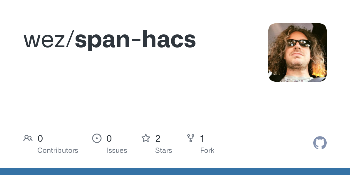

Just got it back up and running. The following fork has resolved the issue:
https://github.com/jeffkibuule/span-hacs.git
Still haven’t been able to resolve this issue. I can access my SPAN panel from my computer using http://[IP Address]/api/v1/circuits and clearly see the data, but every version of SPAN-HACS that I use gives me the same result when entering the IP address of my panel during the process of adding the SPAN integration to Home Assistant. “Unknown error occurred”
Last effort was using GitHub - wez/span-hacs and firmware version “spanos2/r202223/06d09”.
This is also working for me.
I got the same thing at first. Installed the integration from HACS and immediately tried to input my hostname but it failed just like yours. I tried name, IP, full web address - nothing worked. Then I just left it alone and all of a sudden it popped up as a suggestion in HA for me to configure. Weird.
Agreed, with this update from wez everything is working as it should. When I uploaded it to HA it came up as a notification to add almost instantly. This version of the integration has been rock solid for me, even exposing some datapoints I can’t see in the Span app. At least it does for me with the latest Firmware: spanos2/r202223/06d09
