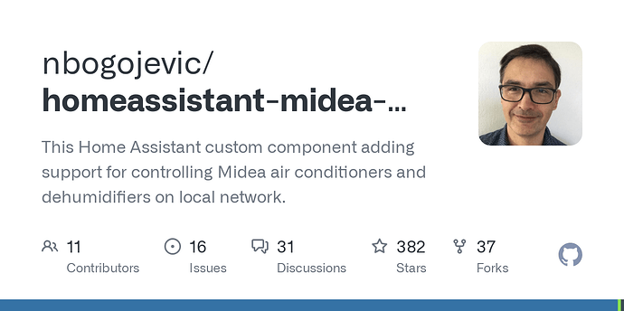

Can you share a link to the repository.
HACS repository
Good. That one looks like it is still being maintained. Unlike another one I found. Also there is an issue open:
If you have any additional logs to add please do. But don’t just reply “me too”. You can thumb up :+1: the first post if you have nothing new to add.
