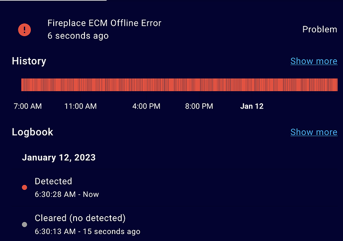

Same here - it’s popping offline and back constantly.

The “ECM Offline” (“3269”) does need to have the ECM (Electronic Control Module) inside your fireplace power cycled in order to clear out. Are you doing that and it is coming back or is it just not reporting for some of these intervals?
Sometimes it works… sometimes it just doesnt seem to come back online…
