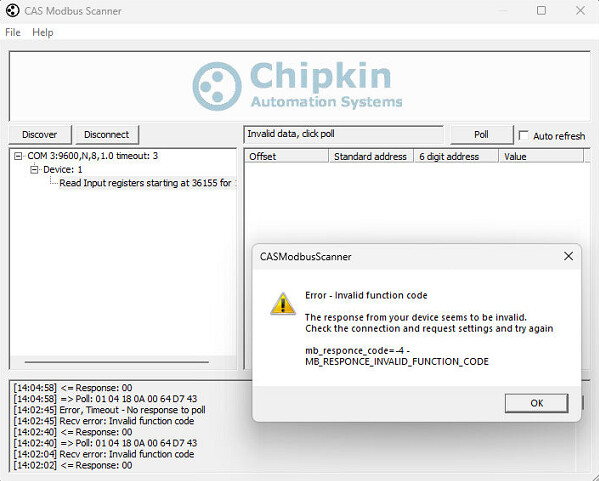

I have all running on an eCactus, but communication over modbus doesn’t go well…
Any ideas?

I’m trying to read the values of my ecactus using a USB ↔ RS485 and using the software CAS Modbus Scanner, I’m trying to “Discover” the battery however haven’t had any luck, I scanned modbus address from 1 to 254 but noting… anyone have any ideas?
Thanks.
