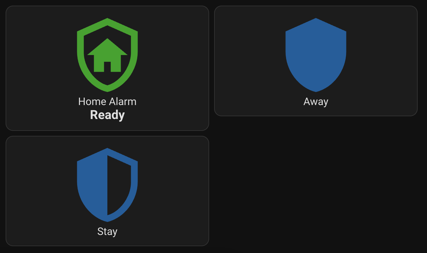

You’re a legend, mate! I managed to get it working and can now arm and disarm using a script in Home Assistant. The only thing I’m stuck on is displaying the status in Home Assistant. For arming and disarming, I authenticate and pass the keys, but I’m wondering what the best way is to poll the system for the status without needing to authenticate every time.
hey. I do not have to. Most methods have:
if not self.session_id and not self.login():
                return False
The login method in ultrasync will set the session.
I actually updated the ultrasync/main.py file and the login method to do the remote auth.

this is what I have. The buttons are clickable and will set the alarm.
