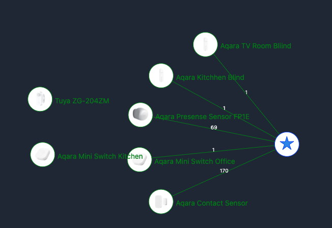

I just set up Zigbee2MQTT on my Home Assistant using the SLZB-MR3 coordinator.
However, when I check the Zigbee network map, it appears that two of the devices are not connected to the coordinator.
Am I interpreting the map correctly?
Is this something I should be concerned about?
What is the “Availability” status of those devices on the Devices tab? I have a few devices that show up “disconnected” that way on the map: it’s because Z2M hasn’t heard from them in months and considers them offline.
@d921 Thanks for your response. You were absolutely right. As soon as I triggered an action on those devices, the connection lines to the coordinator appeared. All good now.
Thanks again!
