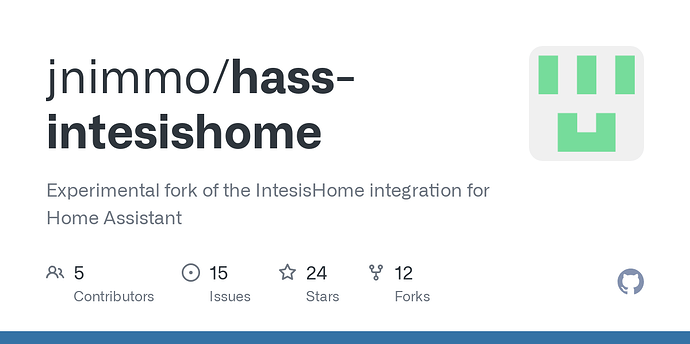

I found this; Request for official inclusion (outside of HACS) of the "IntesisHome (with config flow)” integration in Home Assistant - #5 by kitopopo
and this;
The official integration doens’t work with local devices…
Not sure if you resolved this? I just switched to this version to allow local control and so far) it seems to work really well:

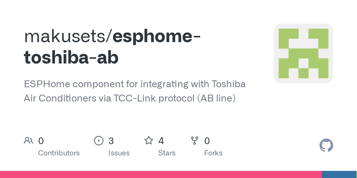

I have a toshiba, and found a nice solution for my AC’s;
https://community.home-assistant.io/t/toshiba-ac-central-systems-integration-ab-protocol/
In my case, my AC unit is a Mitsubishi MSZ-HJ35VA, which is quite old and does not have any accessible communication bus for local control. Therefore, ESPHome/TCC-Link solutions that work for Toshiba units are not applicable to my system.
