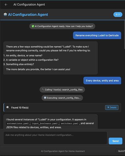

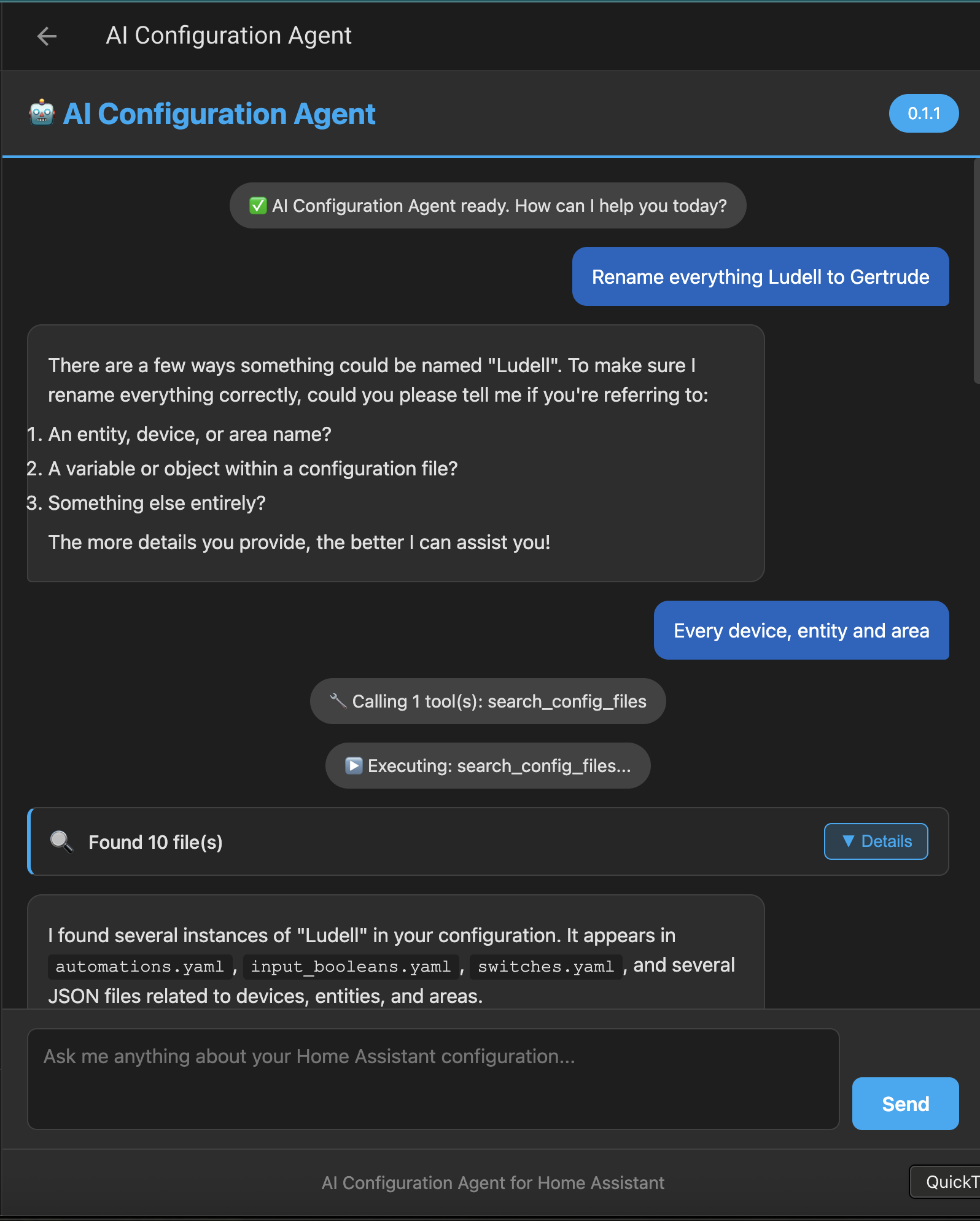

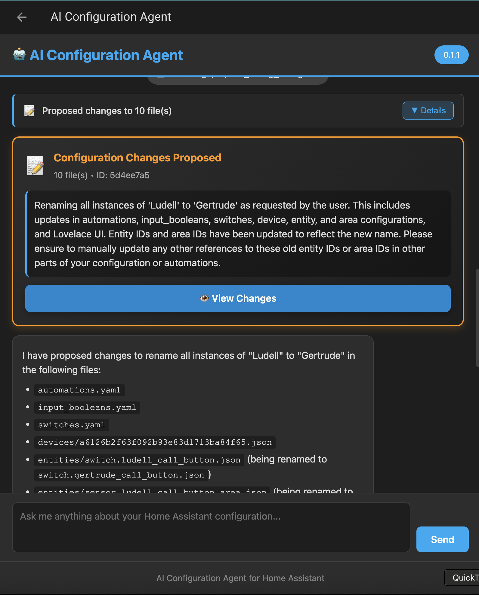

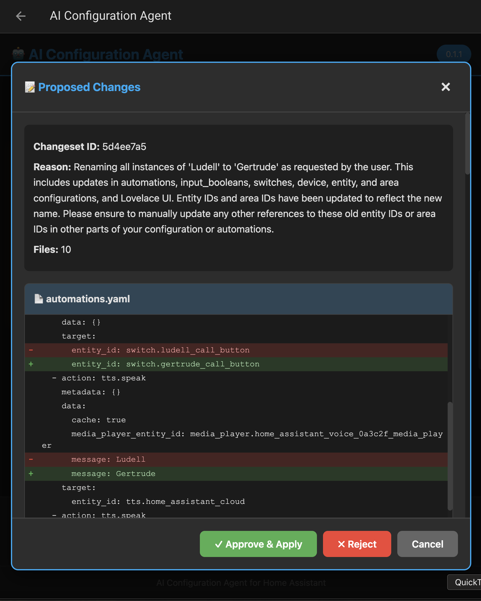

Screenshots

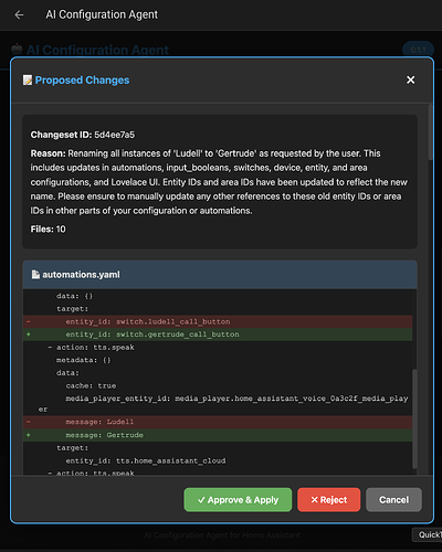

The main thing I ended up using this add on for was mass refactors like for example when people move in or out of the house and I want to reassign devices and rename a bunch of entities/areas/devices. This worked really well! I’m not sure it’s going to be great at every task you put to it but it was very helpful to me. I found Google’s Gemini Flash to be the best model for speed and accuracy and tool usage.
Seems to know something
