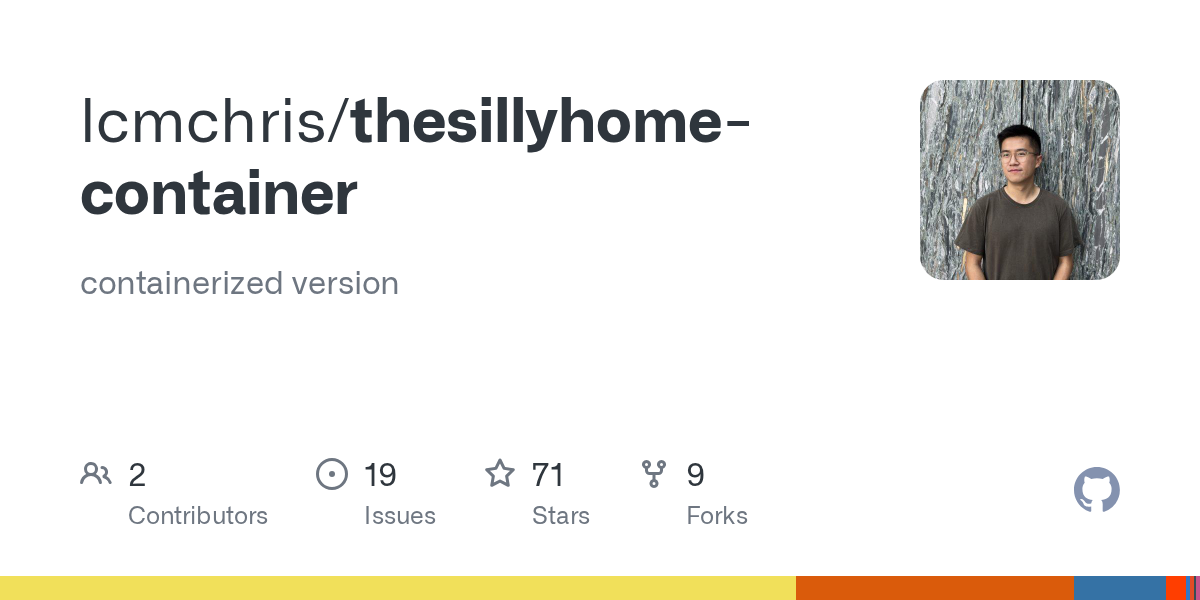

Hi @Cao_Hoa
Thanks for expressing interesting in the project and I’ll try my best to support you.
The main reason for the lack of support for other installations types is that I personally don’t have those setup so it will be quite difficult for me to test it out.
Let me know if you any success converting this to a container but feel free to add a enhancement request onto the Github Repo for this.
@Nova
interesting. I also run HA in docker so addon wont work.
i notice you load the appdaemon app into your ai image. Are you building an instance of appdaemon on your image itself?
I run appdaemon on a separate container, So I can add the app in the normal appdaemon insstance. Is this app designed to communicate with your image/python script?
I’m an enthusiast with some docker knowledge, so looking at your repo your dockerfile is already there. Would creating the app in appdaemon separately and building your image without it work?

Hi @juan11perez and @Cao_Hoa ,
I’ve created the container repo here.
Unfortunately nothing really works yet with the new setup but it would be awesome if you guys could at least test out the docker-compose .
It should at least:
  1. Start a node server listening on port 2300. You can access it on localhost:2300 but nothing on it works. I am a frontend noob to trying to get grips with how I can use it to trigger sh, py scripts, edit config and such.
  2. Kicks off the processing but the default config is set to my instance (so should error out for you). You can try to edit the hesillyhome_src\data\config\options.json file with your instance. What is the best way to keep the config sustained through different docker runs?
Any advice would be sweet but will keep powering on!
