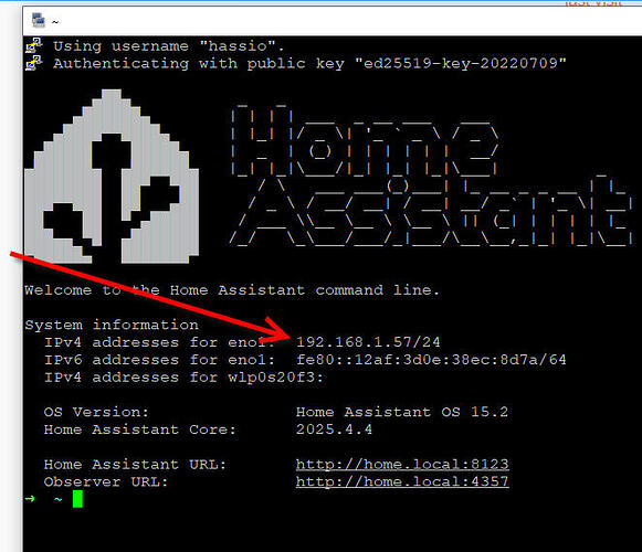

What do you have on this line?
This morning:
IPv4 addresses for wlp2s0:
IPv4 addresses for eno0: 192.168.1.159/24
IPv6 addresses for eno0: (there are 3 of them, I’ll type them out if needed)
Apparently a good night’s sleep solved itself, because the URL now works (I have to use the truncated format, but it runs)
htto://192.168.1.159:8123 should work.
