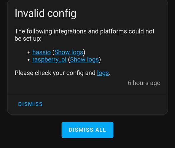

My HA OS is dumping this error everyday at 6am, basically if I restart HA it works fine but breaks again on the next day, and background automations still seem to work even though HA panel seems limited with missing add-ons.

I tried already deleting the raspberry_pi chunk of code from the config but to no help as it shows up again. I have also tried upgrading several times.
