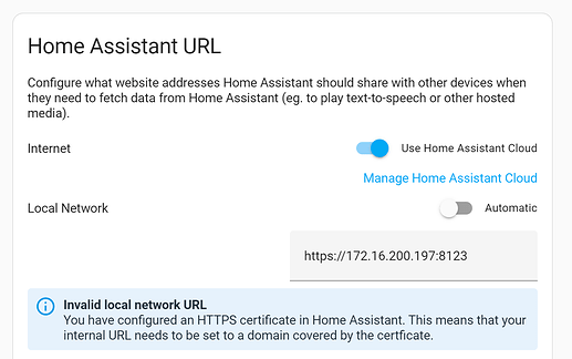

Hi folks, can anyone advise on how I overcome this obstacle? It is saying that my local IP address (inc. http://homeassistant.local:8123) is invalid as my HTTPS certificate needs to cover it. Please note, although the screencap indicates I’ve manually typed https, that was just me testing if that was all it needed (wishful thinking on my part)… So it was - and has been restored to the default http and the ‘Automatic’ button has been resumed. Still no joy from either.
I have got duckdns as one but I also use the paid for HA Cloud, which as you’ll observe is enabled.
This same error occurs when I look at the voice assistants page.
So, any help on resolving this would be greatly appreciated.

Certificates are only valid for names, not IP addresses. The error is telling you to supply a valid fully qualified domain name with https:// not an IP address as you have done.
I have to ask, your screen shot shows you prefixing your local address with https://, have you changed that to http://?

Hmm, well how do I make a local domain?? It doesn’t accept homeassistant.local:8123 so I’m at a loss.
