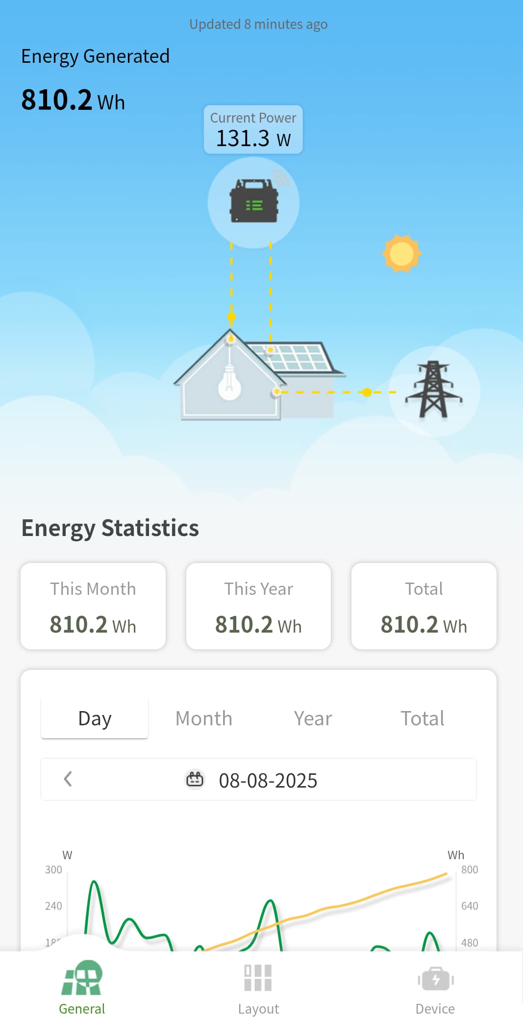

I was forced to register a cloud account and in the App I have a Dashboard.
The App is called “Inver Energy” or “Minverter”
it looks like this:
