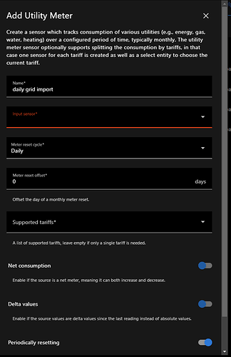

You can create two utility meters to measure your daily grid import and daily grid export using the helper functions. For the daily import use the real energy consumed sensor as input and for the daily export use the real energy produced. You can display this on the card and also compare these to the values on the energy distribution card.

Thanks once again @slipx06, i have created those, now need to wait for some sun! :rofl:

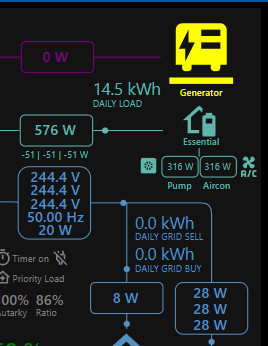

1 question: How do you position additional loads in the chart (location)?
You specify the number of additional loads that you want displayed using the additional_loads: attribute. You can further customise each additional load

Thanks but I meant location as in pixel position
Position of heat pump and charging station.
Unfortunately you cannot change the positioning. It centers the text below the rectangle. You have to shorten your label due to limited space or change to a generic descriptor i.e. Load 1, Load 2 etc.
But in the lite card or examples of the card I have seen are like the example
Where 1 load is above the house and another below.
I had that with the lite card but not in the full card mode.
This is by design. The additional detail on the full card does not allow for that layout.
Ok thanks for letting me know!
