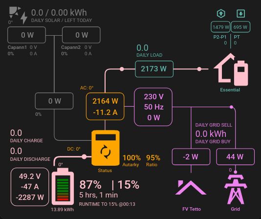

Hi. My setup is a little unorthodox in that:
  • the house is powered by an off-grid inverter with batteries (this fully managed through solar-assistant), which also has AC input
  • in addition, I have a separate, non-managed grid-tie inverter (shown as a rooftop below) which is connected in parallel to the energy meter (I have two CT clamps measuring PV production and grid export/imports, respectively)
    I fiddled with the card a little and came up with the following:
So I mapped the grid-tie inverter production as a “non essential load” – I did not use the aux since it would appear on the upper part of the card, next to the load, and that would reflect the actual connection to the “input” side of the main off-grid inverter.
Apart from the misnomer, it all looks good EXCEPT for the flow indicator from the grid-tie inverter aka non essential load, which would be reversed (down TO the rooftop instead of up FROM the rooftop).
I tried setting grid.invert_flow to true but that would also reverse the flow to the grid (TBH, I’m not even sure what’s the whole point of that setting…).
So to fix that, I added a new grid.invert_ne_flow setting which at least fixes the flow (from the roof to the inverter). The color of the roof still follows the grid direction (import/export) whereas I’d like it to stay constant but that’s a minor detail.
So two questions:
  1. Does my approach make sense or is there a better blueprint for covering my use case?
  2. Is there a way to get some visual representation of how much power I’m importing (relative to contractually allotted power, i.e. 3.3kW), so to get a visual warning before the meter trips for excessive power import?
I’m willing to open PRs if my proposals make sense.

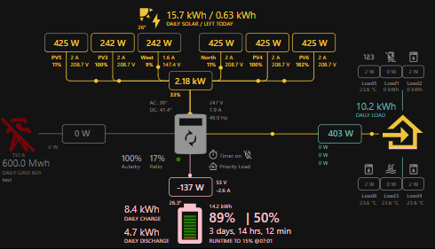

how do you get so many essential load values? in my case whenever I select more than 2 to monitor the power/ energy it combines it into one big icon without any values…

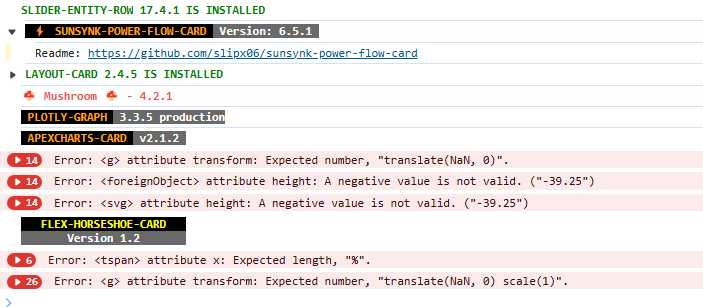

Good morning,
after updating to version 6.5 the case and battery icon disappears every 30 minutes. Then by refreshing the page it reappears.
I cleaned cookies and other things from the browser…
Hi. Have a look at the docs. It depends on your configured view type
additional_loads: Optional 0 Display additional loads on the essential side (0/1/2/3/4/5/6). Three loads will only be visable when using the lite and compact card. Up to six loads can be displayed if using the wide screen display mode. Four or more loads are only visable on the full card if show_aux: false.
I wonder if its related to performance of your system?. Anything in the browser logs?
It also happens on Iphone 15 Pro and Lenovo M10 table.
Where do I get the logs you are interested in?
Press F12 and then check console logs.

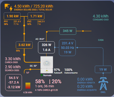

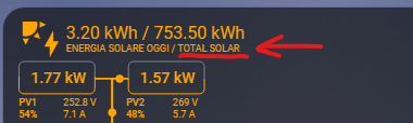

Good morning,
If it’s not a problem, could you provide a translation of this string? every update I have to modify manually… Italian language.
Thank you!!!
No error…
